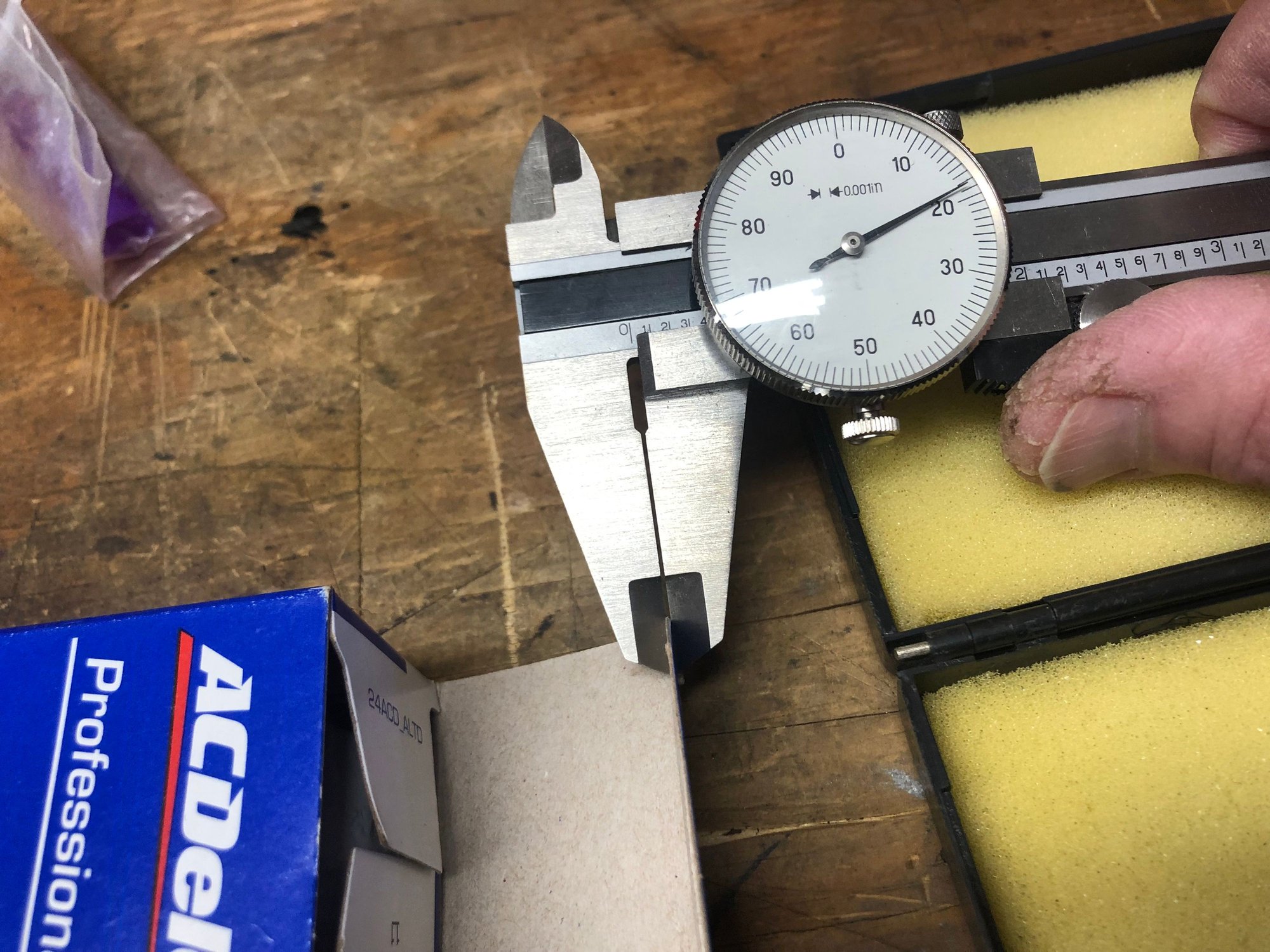

I just use the flap on the cardboard box the points come in to set the rough gap. On a manual trans I’ve just left it in 4th gear and nudged the bumper to get it on the high spot. Set it with a dwell meter after it’s fired up

I didn't say matchbook I said flap on the box the points come in. What does it mean in 2023? Good question. Answer is: about what it always did. I'd still check the dwell with a meter feeler gauge or no from habit.
Before anyone has a canary, I run Echlin points and capacitor, These were just handy in the 'get you home' bag. Which I haven't ever needed. Yet anyway.

I'm not the OP but no worries from me. I just thought if I actually showed the stupid flap trick someone might believe me.
