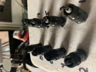

Pulled the plugs and the passenger bank all look fouled. They were brand new when I installed them. I failed to also mention that the carb was recently rebuilt by Lars. I’ll check compression and vacuum tomorrow. Keith

All of them on the right side. Starting to look like that intake manifold gasket wasn't installed correctly. Compression test will likely confirm this.
