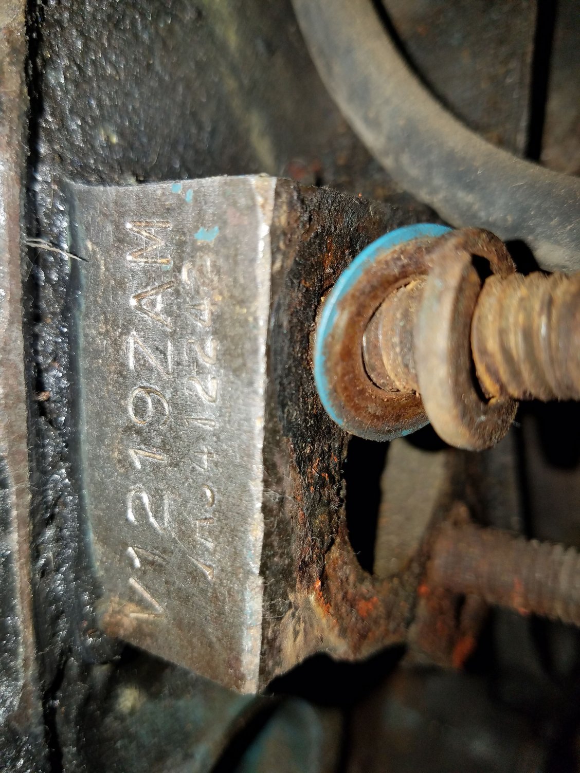

Default Info on engine stamp
What is it? The guy i bought if from had an 80 C3 and had this engine but hoping to decode the stamp...

ZAM indicates a 1980 L-48 engine with 4 speed. Is your VIN 1Z878AS412242? If so, you have the original engine.

Default L-48 4 speed
So this would be a 305. Its a motor I purchased from a guy. The story is that a fella had a 1980 C3 and had a bunch of extra parts both OEM and mod parts. The guy did a lot of mods to his car. He sold the house he was living in and left a bunch of stuff there when he left. The new owner put a set of gauges up for sale..everything except the speedo. I bought those from him not knowing what else he had. After i had my son in law pick up the gauges he told me thay guy has a bunch of stuff if your interested. Anyway i said sure and bought the guy out not really knowing what all he had. This engine was part of the pile. The guy even left the hòod of the car there after he put a cowl hood on it. I am going to look at the hood today and see if there is an indication it came off the car with this motor. I dont know if he bought this motor or took it out of his car when he was doing the mod project. Thank you for your time and info!! Thinking if I cant find the car it came from I will probably put it up for sale. My 1980 has had a motor swap and didnt come with this motor and mine is an automatic. The hood on mine is in good shape so i will probably put that up for sale. The motor still has the smog pump and air cleaner on it. Gotta see if the cylinders and valves hold pressure and turns ok but the oil in it looks very clean. Any ideas on motor and hood values? I know its hard since the condition of the motor is still unlnown.. i just dont think I will be using either..

The L-48 and L-82 for 1980 were 350s. The California only LG-4 was a 305. Engine suffix code indicates your engine is a 350.

Default Oh! Ok well thats interesting!
Now I have to decide condition. Probably going to have to get around and go play with my gauges and compressor to see if there is any apparent problems. Since the guy also had a new performance cam and lifters im thinking he was going to use the moror but didnt. Since its a 350 it might be worth building. Hmmm decissions, decissions.Thank you!!
