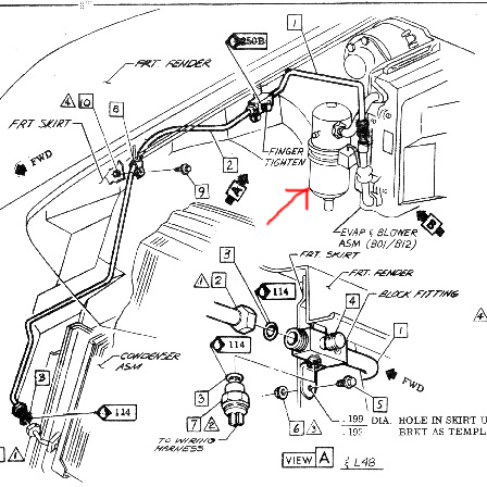

I am trying to install my R134 A/C this afternoon and I am stuck at the beginning. The instructions say put 8 oz. into the system. 4 in the compressor (already in the new one, came that way), and 4 oz. in the accumulator. Is the picture below the accumulator?

Yes, thats your accumulator. And yes, use the oil in the kit on your o-rings. NOT any other type.
