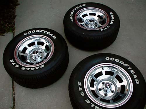

Pay some professional shop to refinish them. Mine went from crap, to :eek:

I took mine to a professional polisher. Had to take the tires off the rims (no problem as I was already going to buy new tires) and they did the work. They look 100 times better. I also stripped and painted the center section after they polished the wheels. I then ordered new center caps from Zip. Looks like I bought new wheels and it cost me a total of $200 +/- and a little time. I now use Nevr-dull to keep them shiny and only polish with the grain. If you go in circles, you can scratch the wheels. No clear coat.
