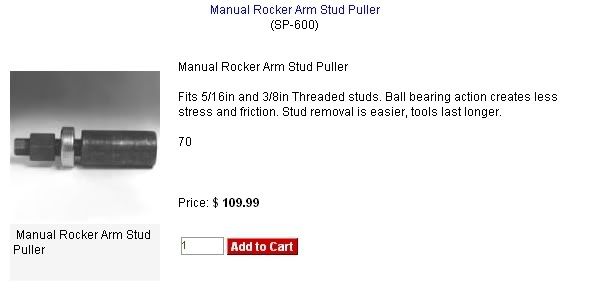

Is this what you look for?
That would be good if I were doing these for a living. The machine shop will only charge me $180 for both heads, and that's with new studs, and assembled with springs.
