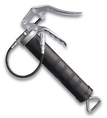

How about a grease gun?
Sears, $34.99
Summit Racing, $17.95

I really like Mobil 1 Synthetic grease also.
I just purchased one of these Lincoln units last month - VERY nice!!
