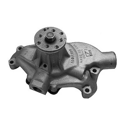

Here are the water pumps that I was thinking about.
I am not set on any of these or even sure if these will fit.
I am very open to suggestions.
http://store.summitracing.com/partde...?part=EDL-8812
http://store.summitracing.com/partde...rsview=sku&Ns=

Well I went with the ATI Super Street Damper Harmonic Balancer and the MSD Blaster 2 coil. I still need the water pump and the starter. I am going to go with the Edelbrock Victor Series Mechanical Water Pump (EDL-8812).
I still need to pick a starter. What is the difference with the Starter Mounting Pattern between Inline and Staggered?

Also...if your going to use the original fan & fan clutch, the water pump must be vette specific. That is..3/4" diameter short snout.
