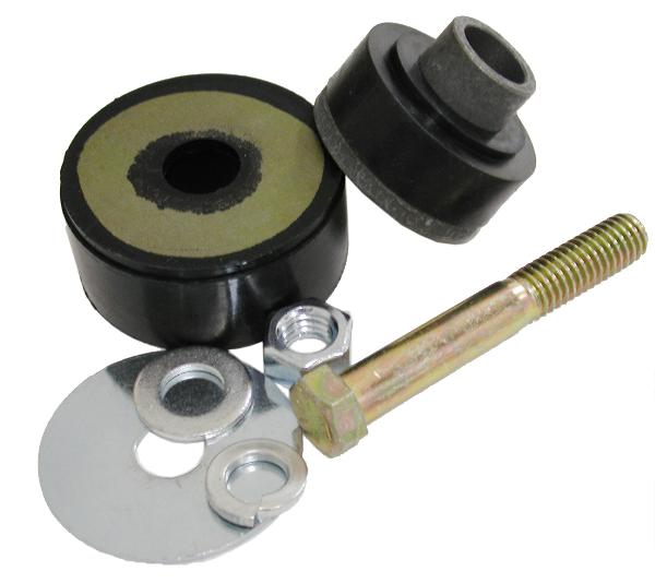

My money is on the front mount... Makes a nasty clunk if gone or beaten up...... Did the mechanic say if the rubber bushing was still in it? It's very easy to see...
Very easy to replace.
Here is a link to the part at Volunteer Vette.

Eddie 70 hit the nail on the head and even gave you photos. your symptoms are classic for this type of failure. If you don't do your own work, this is a fairly straight forward repair for your mechanic. If you do your own work, this is very easy to do, just count on scraped knuckles and an hour lost. The procedure is in the GM Service Manual.

I really doubt that a visual inspection will show anything for the simple reason that the only thing that can be viewed is the bolt head. For the cost of the setup, guessing around $45, it is pretty easy just to swap out the old for a new one. That rubber doughnut sits up in the front of the differential mounting point and sits between the frame and the diff nose. The GM manual gives the procedure, even telling you how to keep the nose of the diff from pivoting up, iirc.

Very easy to see if it is missing or torn to bits though... at least the "doughnut" bottom half between the differential mount & the frame support is... On my 78 it was completely gone, bolt & all.. Talk about easy to spot...

Not yet. Car is still in the shop being checked and tuned. Mechanic said the front bushing and all mounting bolts are tight and in good shape. Doesn't appear to be u-joints either. He thinks its coming from inside the diff. When I get it back I'll double check everything and then will change the fluid to see if that helps. Previous owner said the rear diff is the only part of the car that did not get any attention when he restored it so maybe it's just overdue for a fluid change.
