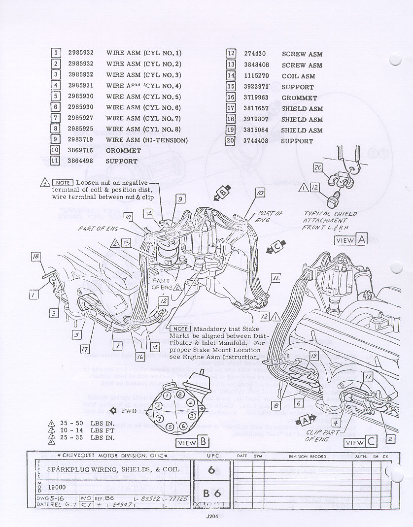

There seems to be a lot of confusion about the correct alignment of the distributor in Corvettes. Unlike most Chevrolet products that have the vacuum can pointing sort of toward the right front wheel, ours need to be pointing slightly back, kinda toward the heater motor. Here is the correct alignment per the 1969 AIM.
When you install the distributor per the drawing, the tach cable will line up perfectly and you won't need to put a kink in it or buy one of those crazy 90° things that just cost money and don't really fix the problem.
Hope this helps,
Pete
