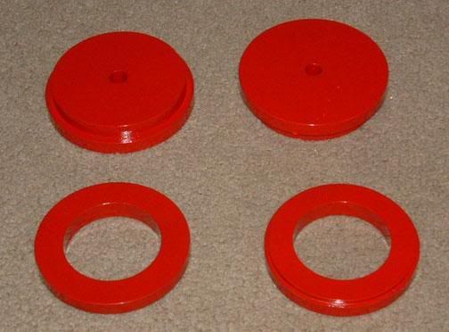

I also have a lowered 'vette ( '71 ) and have been looking at how to gain suspension travel, i then stumbled across your thread and read the GM Corvette Chassis Preparation PDF
http://www.corvettefaq.com/c3/ChevyPower.pdf
The GM book says you can remove the stock rubber diff carrier mounts and put steel plates in and you have some freedom to raise/lower the carrier, do you or anyone else know anything about this? I appreciate the rubber is there for a road car but could thinner rubber be substituted?
In regards to your conversion to the later ali carrier and forgetting the weight saving, was raising the diff the primary purpose? if so is this the only way to do it? I'm not fussed about the weight saving so for me it's a lot of work to get 1/2"
Hang on, i've just realised this won't increase suspension travel, only help to bring the half shafts straighter on a lowered car confusing myself now!
ha ha, anyway let us know what your motives were, thanks and good work! Aaron.

The Chevy Power book is referring to disks like these...
Raising the diff is meant to improve the angle of the half-shafts on lowered C3's, as once they go below level at the diff ends during travel rear toe moves increasingly towards toe out. Don't know of any current source for them, but if you choose this route I've got dimensions for fabbing up a set. They can be made of steel or aluminum.
IIRC, Bee Jay converted to the batwing primarily for weight reduction, raising the diff while convenient. Don't overlook pinion angle if you raise yours by any means. Hope that helps.

I did the batwing conversion mostly for weight savings. I had planned on raising the diff by 1" but discovered that 1/2" is the max without modifying the floor of the storage area. I hope to lose even more weight when I bolt on an '80 to 82 diff.
