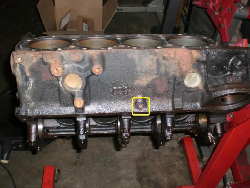

Here are some pics I just took to help you locate them on the block, per side.
Driver's Side Plug Location:
Passenger Side Plug Location:

I found the driver side plug...sheilding needs to be removed. However I cannot find the passenger side plug.
Does the starter need to be removed?
Old Dec 19, 2008 | 06:28 PM
noonie's Avatar
noonie
Joined: Mar 2006
Posts: 14,112
Likes: 28
From: Florida
No,
The ign shielding must come off.
Crud blocking the drain hole with plug removed
What was inside the block. Flush it out well before the new radiator or you will plug the radiator.
