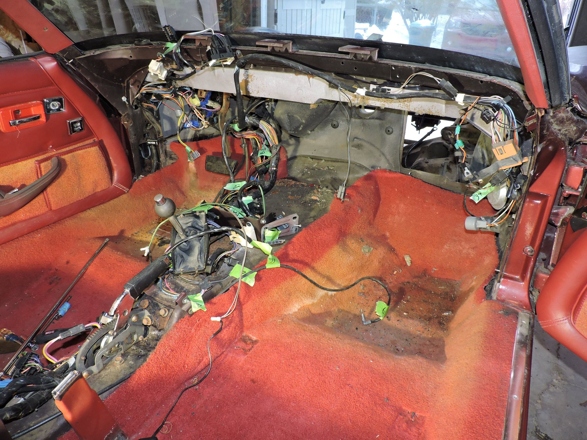

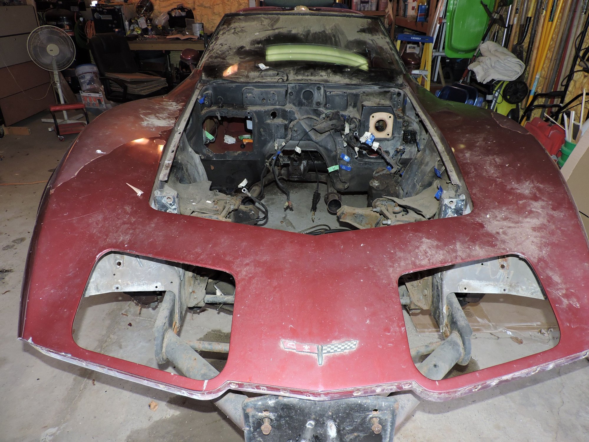

LOL - pretty funny reading back through original posts!!! After a couple years of overthinking what to do with this car I ended up doing noting. A few more years of divorce, new house, new kids, new wife, new addition, pretty much life.... the only thing I ever got done was to pull the engine out about 3 years ago and start to inventory what I had. Turns out its a matching numbers car, I was quite shocked, seeing it had some work done I was guessing it had at least a new motor at some point.
I'm just now finally getting back to this project. Since its matching numbers that makes a lot of decisions easy for me. I'm not going to hot-rod it with a replacement motor nor convert it to manual. Just going to tear it down, clean/fix/replace and put it back together. It already had all the smog stuff removed and headers before I got it so I think I'll end up doing engine rebuild, maybe some mild upgraded heads, bore, cam, intake. I'll upgrade the suspension as well, but again not go all out to coil overs or anything overboard. I might convert some of the vacuum stuff to elec. like the headlight doors.
So far I have the engine bay pretty gutted out and just have the wire harness and trim to finish up on interior and I'll be ready to lift the body off. Really lucky how well its all come apart so far, very few rusted solid or broken bolts. Lots more to do but nice finally getting some time to work on it and having some direction.

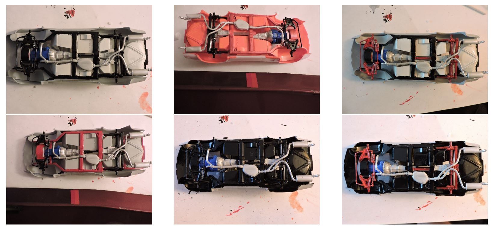

Which do you prefer???

Hey life happens! Understand. Been on mine for nearly 10 years and had a bunch of delays. And not very far from where I started. So be sure and take pictures (keep them on the cloud in case you lose the phone or computer) or better post them here on your build thread on the forum. Bag and label all your parts. Keep your bolts and hardware together and labeled. Good idea on the models to test ideas. Personally I like the bottom right one best. Think you are choosing a good route with just doing mild modifications. Are you thinking painting or powder coating? Good luck. I am sure you will have lots of questions as you go along and these guys are a great help. Stay at it!

LOL... posted this to my very very old thread when I first bought the car... meant to put it on my build thread. https://www.corvetteforum.com/forums...e-project.html
But I hear you it does happen and can change on a dime for sure!! I have lots and lots of pics and label's, good thought on backing them up will do that! I'm leaning to the bottom right as well, would like a way to get the frame to jump out from body a little more if I can. I'm having all the metal acid (Alkaline really) dipped and then E-coated, goes in on Monday.
