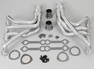

Local corvette shop said to use Hedman.
Anyone have these on there C3?
http://www.summitracing.com/parts/HE...8/?image=large

All the Hedman's i see have footnotes saying wont clear steering damper?

had these last week, none ceramic... was happy....

The Hedman headers are not tuned and don't appear to be equal length while the Dynomax may not be tuned but do appear to be equal length.

Note the near-straight-down from 4-6 and 3-5 cylinders. I had block hugger headers like this (but stainless, not ceram coated) before the Dynomax ceram coated I have now. The straight-downs come too close to the motor mounts. The ss headers I had melted the urethane pads. I had urethanesicles hanging below the mounts.
