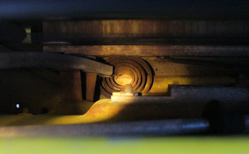

On my 75, the driver door has seen better days
The first problem is the window, it's electric and works,
except that the window doesn't go up all the way,
it stops about 2 inches from closing, but keeps trying to go up.
it also moves really fast compared to the passenger side.
I took off the door panel and found this in the bottom of the door.
Now what?
The other item I need is a new door panel,
what's a good place to get one?
Also, since i got the door open, what's the best grease for the window tracks, and for locking mechanisim?

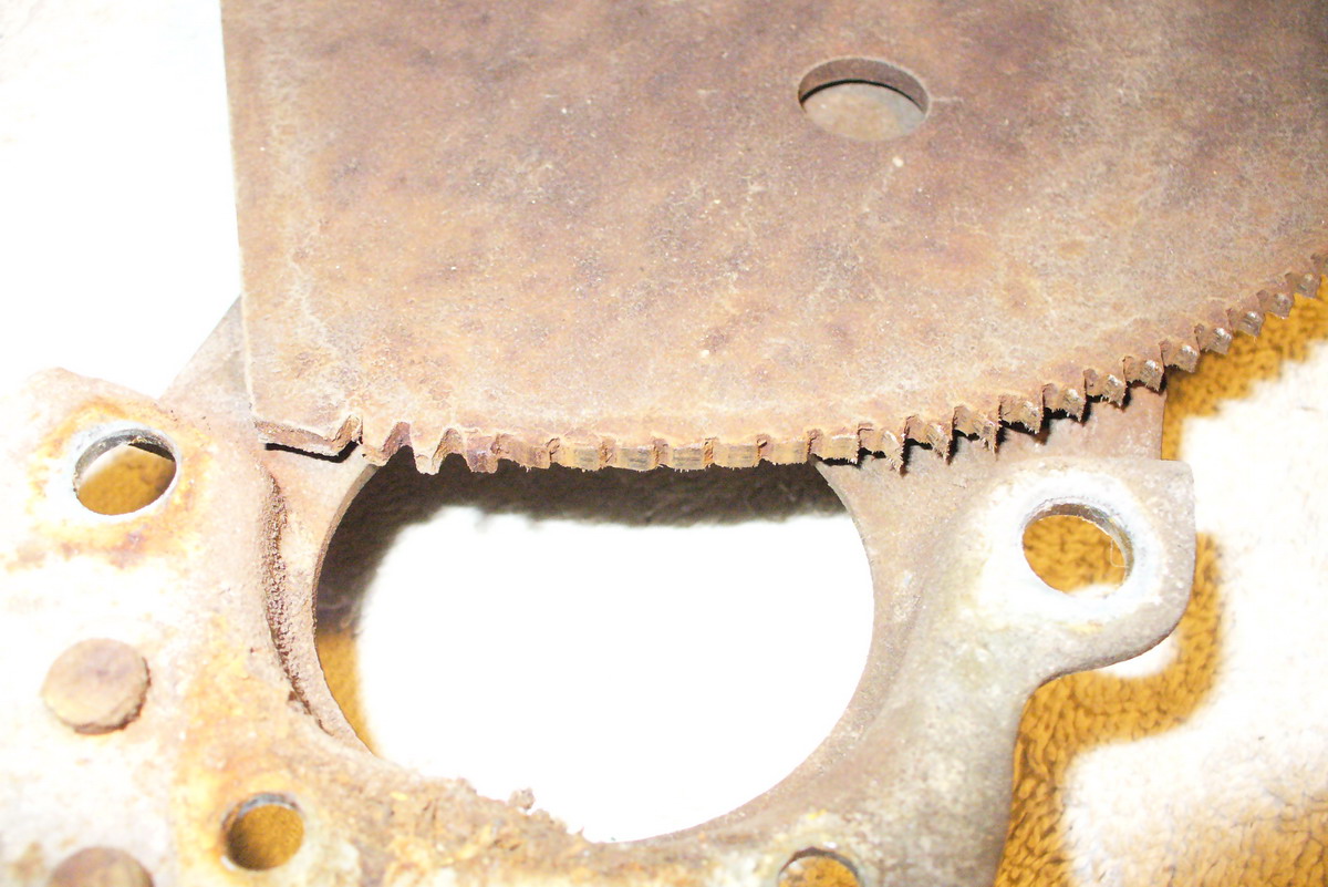

You have two problems. The regulator teeth are gone at the top, and the spring is broken. both can be replaced, or you can buy a new regulator.

Springs and regulator are available....I think Yogi Bear is the guy I got mine from, years ago....
the tracks need be soaked in gasoline overnight and scrubbed clean, broken nylon replaced.....
I would not put ANY lube on the tracks....all it does is dry out and you got same situation in a few years....

Well, here's what a bad regulator gear looks like
To Window & door problems on a 75
