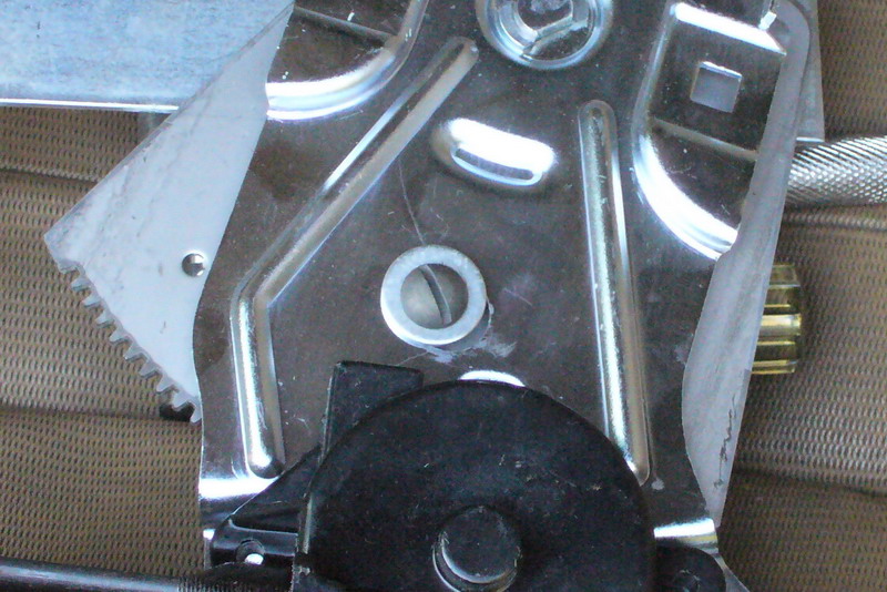

I replaced my power window motor, gears and linkage with new parts, nothing old in there anymore.
My other thread was http://forums.corvetteforum.com/c3-t...on-a-75-a.html
now I'm still having the same problem, the window won't go up all the way, it stops about 3" from the top still.
I've looked in there but can't see anything blocking the lift gears.
I'm wondering if the motor has a top and bottom in it, and that it was not installed at full top position on the gear.
I feel that I've missed something while putting it together.

Are you sure you have it put together right? The on roller is on the regulator. the other roller is on the window. As you can see the front roller is on the window. the back roller is on the track. Also the bolts that replaced the rivits can not be too long.Example...

thats a great picture on how it works in there.
I don't have the glass in yet, so the front roller is not in this problem.
the back roller is working when the top rrail is in.
I'm going to remove the top bar and test,
if still not working, I'm going to take it out and bench test the unit.

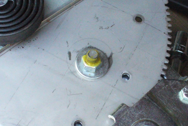

Ok, I'm the idiot!
In my field, we call this a OM problem, Operator Malfunction!
It really helps if you remove the shipping lock.
It has a bolt thru it holding it together.
Honestly, it had that locktite stuff on the nut so i thought it part of the system.
I hope you got a laugh outa this, I did.

That bolt should of had a sticker on it saying 'Install Motor and then Remove Bolt' since the spring needs a 'preload' on it to help the motor push the window all the way up. Glad you posted a reply and that you finally got it to work.
