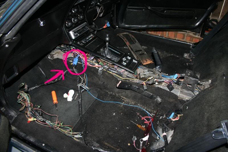

some people on here will grill you for removing the computer and i have been bashed on here plenty of times for doing it but i would rather take a paintball between the eyes then go back to the computer .....i got rid of it 3 years ago. the wiring harness comes out in one big hunk. its huge. disconnect it from your computer. computer then comes out no problem. disconnect it all from the dizzy and carb and drag it back through the fire wall and the centre consol. then get rid of all those polution controls and sensors to clean up the engine bay.
-put in the new carb or distributor of your choice and job done if you have a manual.
-if you have an auto and keep that original loc up converter tansmission then search the tv cable method on here to take advantage of that loc-up.
- me myself i didnt want a loc-up converter so i replaced the whole transmission .
-nothing will change as far as dash lites, cruise control, tach,speedo will work fine.
the AC wire you can see that i circled in pink is the only wire that i had to unclip from the computer harness that went into the main wiring harness to remove it.
( yes the wiring in the floor in the pic is the computer harness)
go from this to this....
