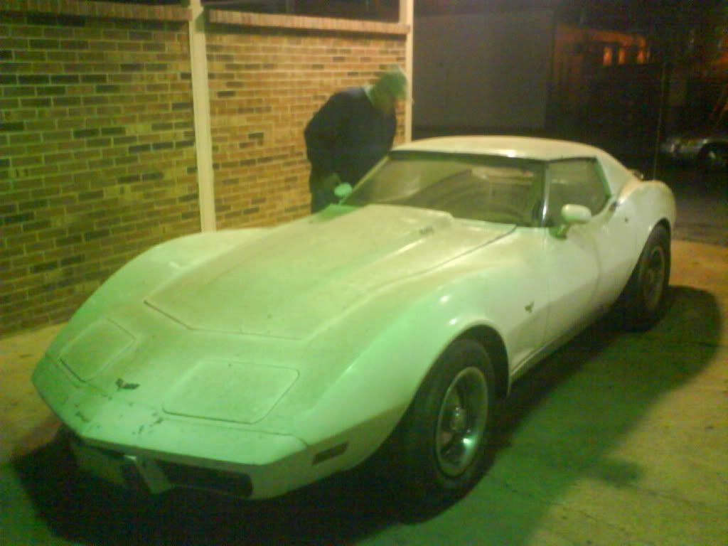

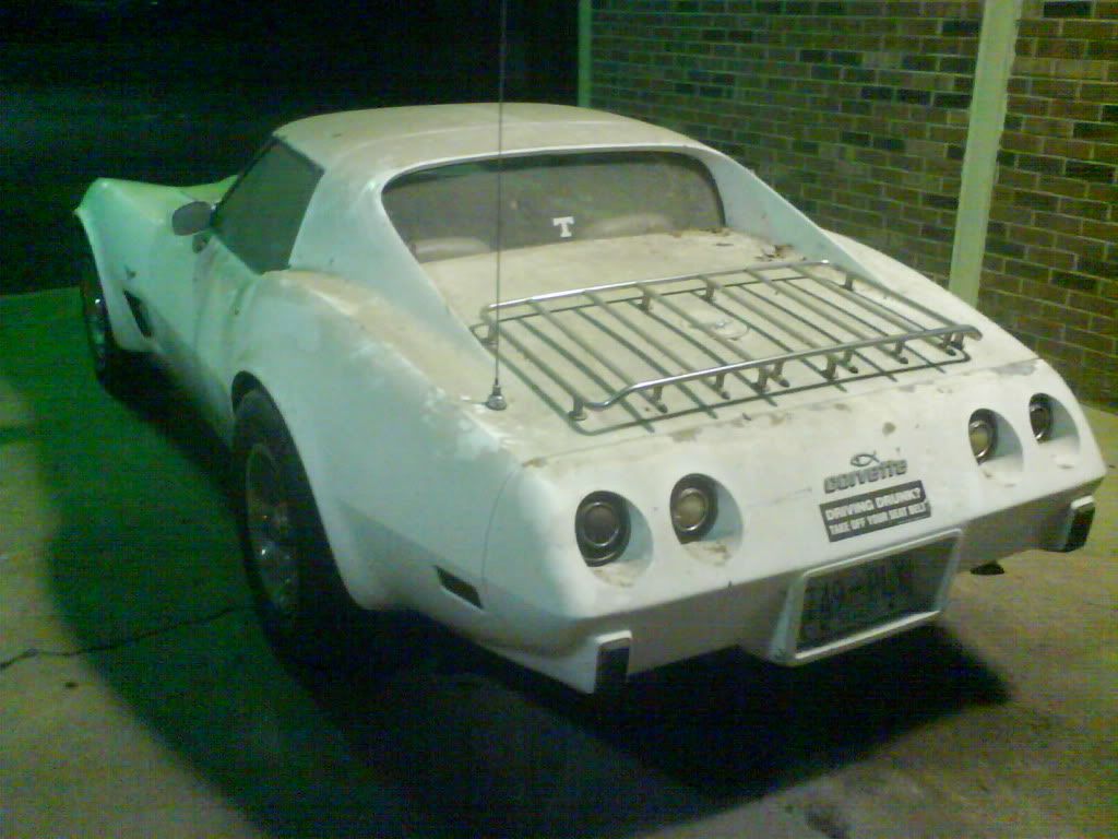

Thought I would post pics of it. This was the night I pulled it out of the PO's shed. Barn Fresh!

The "power T" sticker on the rear window is like dragging around a boat anchor. . .
