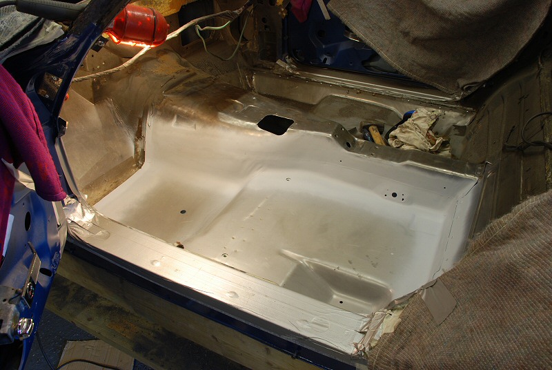

This my work in progress:
I have removed al the rust on the surface with the brush,and then I have removed the old seal and repalce it with a new one.
Here you can see the white stripe.
I have applied a rust converter and then I have sprayed the floor with "putty"(I don't know if is the correct world)
The heat insulator:
The job as done and the carpet is back

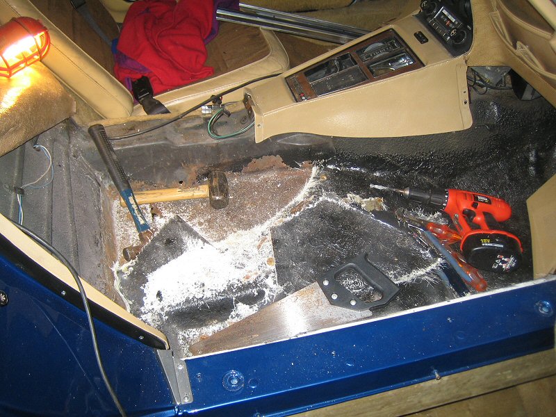

Here's my '76:
Before
After
It'll be POR15 inside and outside, followed by factory-style body seal on the underside and locally inside. I never want to do this job again.
