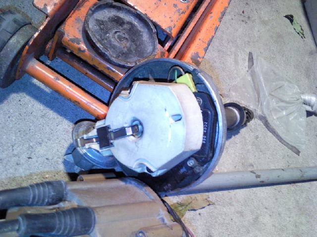

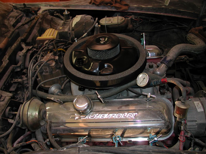

I'm looking at some old pics, to prepare my engine build up. I realized something! I have a HEI converted dizzy, and an additional COIL!
Other then that the coil on the dizzy could be broken, is there another reason for this?
Could I buy just any HEI distributor cap to replace it, or is this a brand/type depended part.

Not sure what you're wanting to do, but your pic looks like an L-88 set up. None of them came with HEI.
Your yellow Accel coil is aftermarket and shouldn't be needed with the HEI.

Hmmm, nothing new there.
But still this is the setup.

with Easy Mike. You dont need the external coil.
You can go back with a standard coil in the cap setup with no issues.

SOmewhere, it was swapped to a HEI and the guy that did it was too lazy to pull the old external coil.

From what I can tell from your picture, it looks to be a GM cap, you would be wise to order a coil and rotor as well,then you are starting with fresh parts that will work together with no issues.

Pretty much just a v8 GM HEI cap from 75-82
Out of curiosity , where is the yellow coil wire from the other coil going ?
