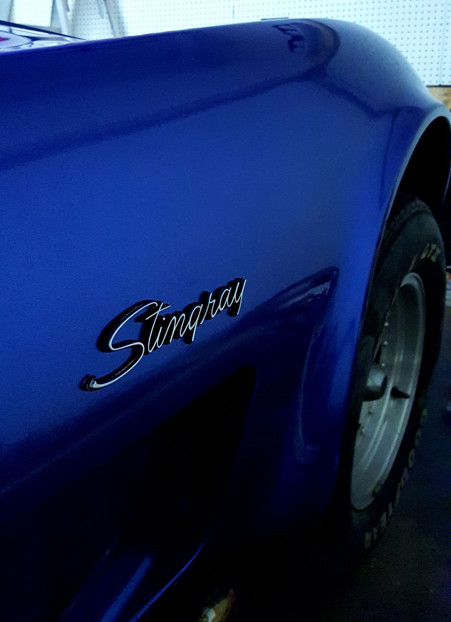

She is finally in full color! TCP Global Firemist Cobalt Blue BC/CC. It had great coverage in only two coats, but I had to add a third w/ drop coat to eliminate any tiger stripes. The paint cane out great, but there are a couple of places I can some body work at the right angle. If I had to do it again I wouldn't have used just epoxy to build with 2k glaze. For a novice a high build would have been better. Over all I'm happy with it, it has been 5 years after all.
