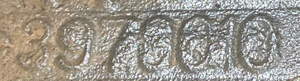

mine looks like a 9 too but there is so much corrosion around it that I assumed it was a zero since I could not find anything with a 9 in that part of the number.

That digit is a "0" with part of the 0 missing on the left vertical stroke. I've seen lots of cast numbers that get 'dinged' during the casting process.
