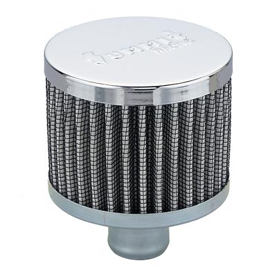

Which style is better for a dual breather set-up?
Aims:
1) Proper function
2) No mess
3) Lifespan
Valve covers have Moroso baffled grommets in them already, and breathers will be push in style of these two types:
Open element:
Closed element:
Moroso grommets:
