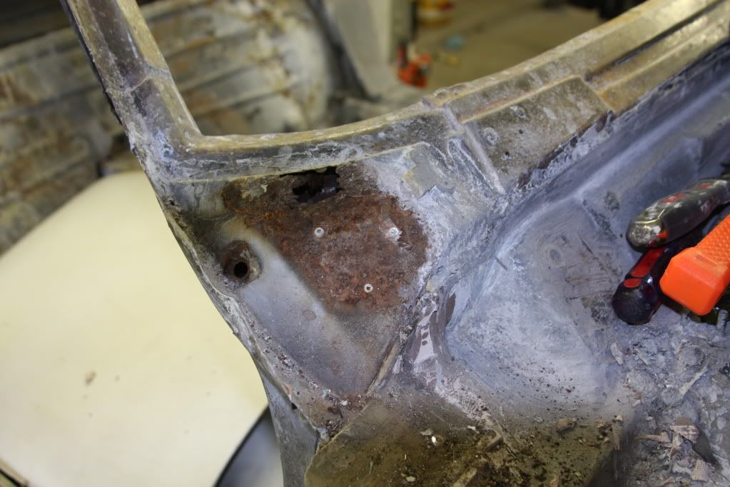

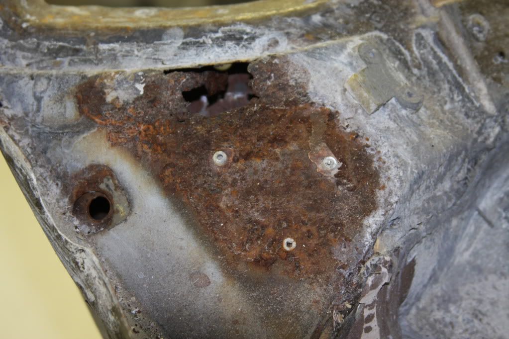

I finally got back around to working on the window frame. I have stripped the car and popped off the front clip ad removed the firewall/to body bonding strips. Looking at the rust, it seems to be only on the ourside part of the frame and just a dusting on the inside windowframe.
I went ahead and hit it with the rust inhibiter while I decide which direction I am going to go in repairing this.
Anyway here are the pics.
Old Oct 31, 2011 | 12:01 AM
  #36
BB72's Avatar
BB72
Joined: Aug 2006
Posts: 3,429
Likes: 20
From: Kingston Ontario
I would be checking the other steel on the body. This doesn't look good.
Rob
Old Oct 31, 2011 | 06:50 AM
  #37
Roco71's Avatar
Roco71
Joined: Jul 2009
Posts: 3,264
From: Vero Beach FL
It could have been a lot worse mine was. That is very repairable.
To Window Frame Rust
Old Oct 31, 2011 | 07:16 AM
  #38
Indiancreek's Avatar
Indiancreek
Joined: Jun 2010
Posts: 1,781
Likes: 15
From: Oxford Ohio
Just in my case, I'd replace the windshield frame where ever it was questionable. I would always know I did a patch job and it would bother me. Probably never be an issue, it would always be in the back of my mind. In my case I know what makes me more comfortable with what I'm working on. It's mostly labor costs more than parts and it's my labor. Really if I hated it I'd be driving a new car instead of owning a bunch of old ones. It's tremendously satisfying to make these cars better, and if well done a source of pride that just buying one all finished doesn't give.
Old Oct 31, 2011 | 09:37 AM
  #39
efather's Avatar
efather
Joined: Nov 2010
Posts: 364
From: Flower Mound TX

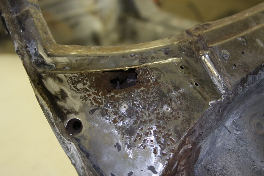

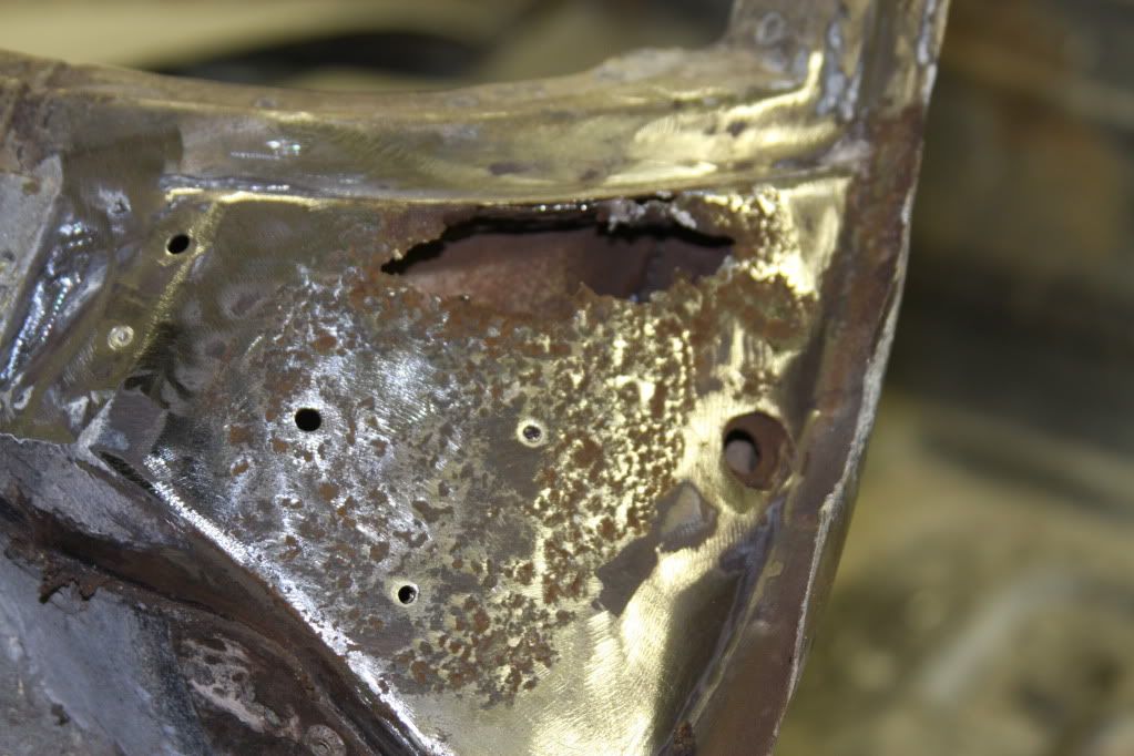

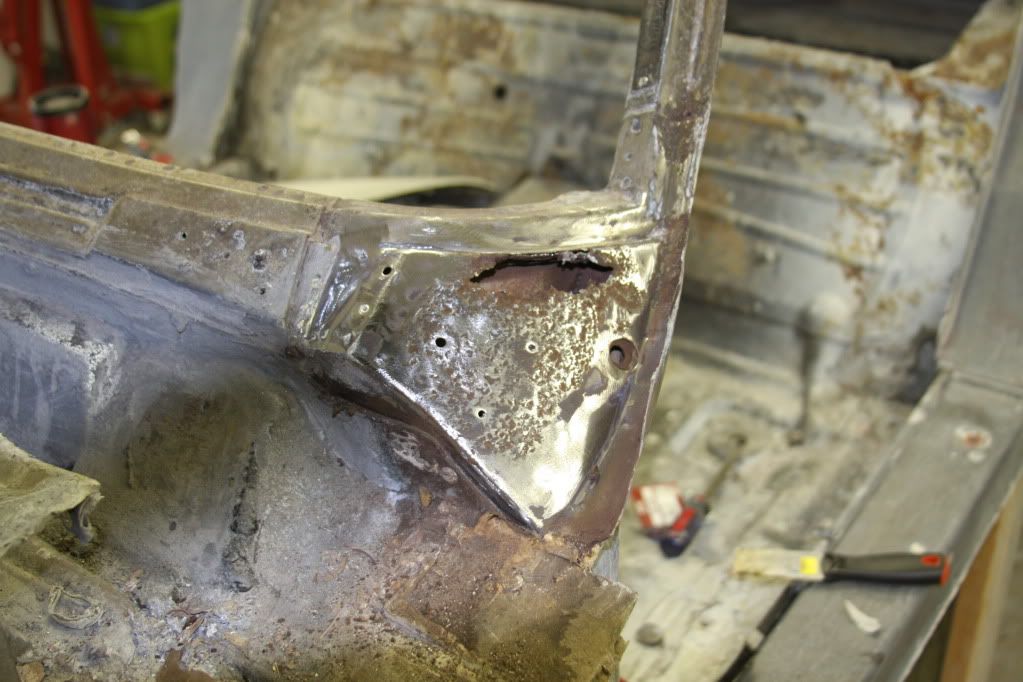

i am off today and am going to clean it up and see the damage. this is the only real amount of rust on the car, and i was able to see inside theframe and it is in good shape, it is just these 2 spots. the driver is worse than the passenger, i am hopefull now that I have it all opened up.

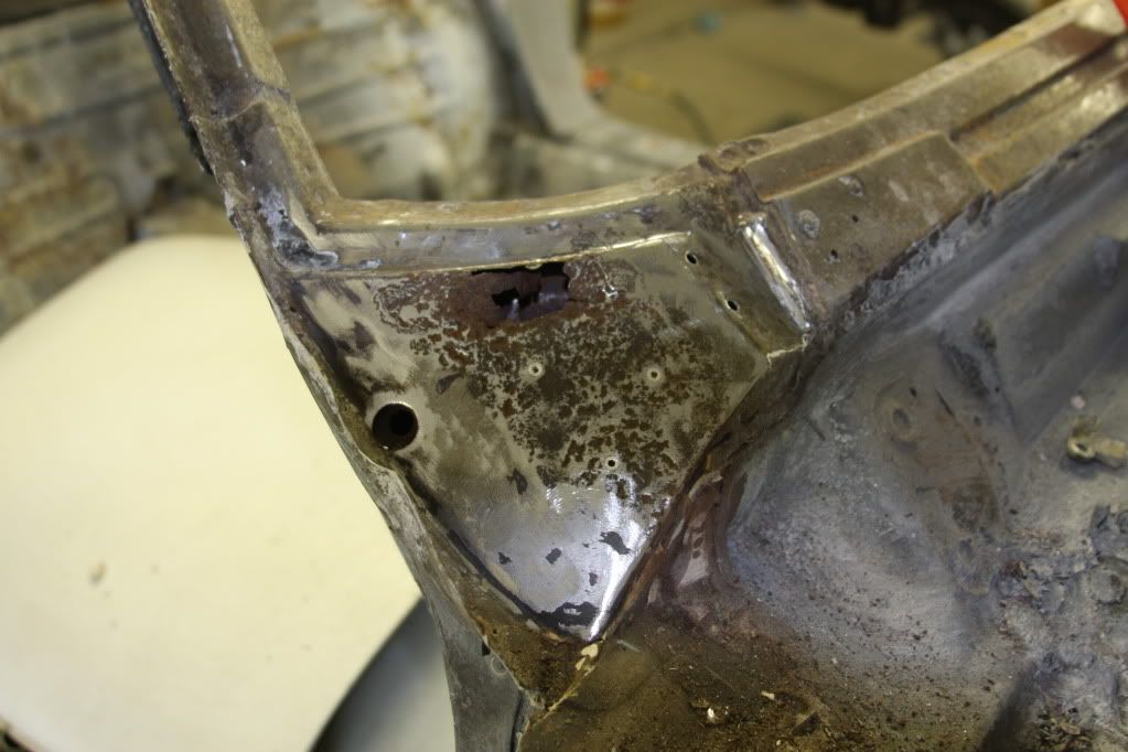

Old Oct 31, 2011 | 11:58 AM
  #40
efather's Avatar
efather
Joined: Nov 2010
Posts: 364

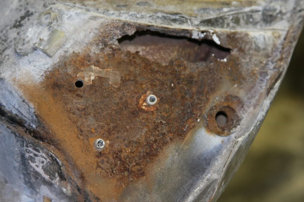

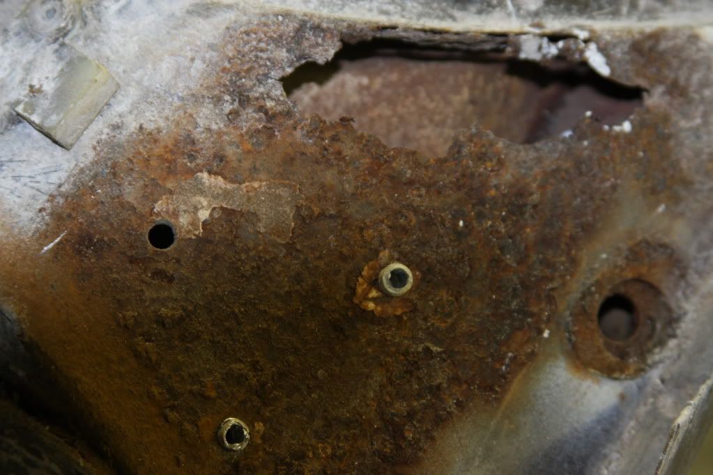

here are pics of the rusted are after cleaned up. Not as bad as I thought (in my opinion) which is a good thing.
