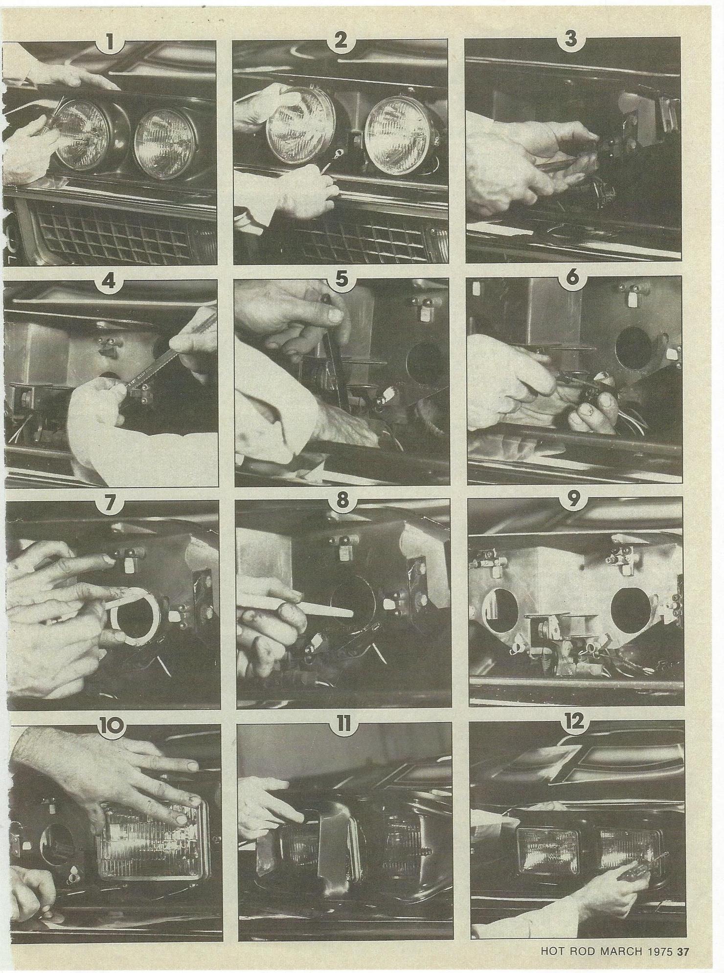

Originally Posted by Mod75
Might help if i put these up, not sure if there will be a conflict with the people that did the article? I am sure somebody will let me know.
This is 36 years old.
Old thread, but any way to get these pictures back on here, Mod75? I remember seeing them a few years ago before Photobucket went to ****

Old Jul 30, 2019 | 08:38 PM
  #35
Mod75's Avatar
Mod75
Posts: 10,684
Likes: 696
From: Danville Illinois
2024 C3 of the Year Winner - Modified
They have been on the car for close to 40 years now, hope the pics are of help. If close up pics are needed let me know.

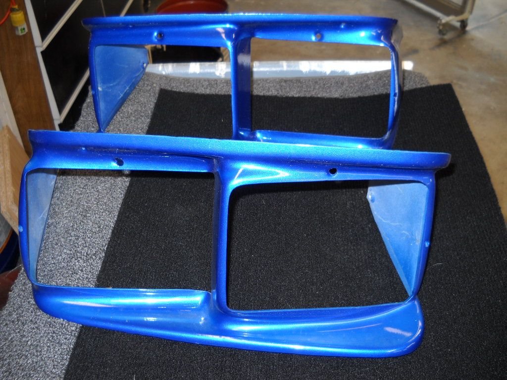

From: Summerville SC
Not trying to hijack this really old thread but I just put this set up from an 86 Camaro on my 78. Really easy except for finding the bezels. I found one good one for the right side. IF ANYONE would happen to have one for the driver side buried under 30 or 40 years of parts and trash , please let me know. I really want to show both headlights off but I might just have to settle for a WINK until I locate a second bezel.

Take your right-side bezel to someone who works in the printed parts industry. There should be a way to scan your part for 3-D modeling so that it could be 'printed' in plastic. There also should be software available to 'reverse image' the right-side part so that it, too, can be printed. If you get that figured out, YOU can sell kits for rectangular headlamp along with YOUR plastic bezels.

I tried that. I even joined a local group that taught 3D printing. They had the printers but not the necessary camera. They were teaching some type of programing and the consensus was that the bezel was too complicated to do without using a camera. And yes my plan was to use the side I have and try to make a mirror image of it. That didn't pan out. A member here was nice enough to loan me a bezel he had to make a mold of it, but after practicing onan old part I had and pretty much destroying it, I thought twice about ruining his good part. So I am now following a few other options, like getting a bezel from a firebird, cutting it as needed ans glassing in the sides from an old C3 bezel. I keep reminding myself that it's the journey, not the destination that is the fun. DId I mention that I have to keep reminding myself of that....Thanks.

Mod75, thanks for reposting the pictures
