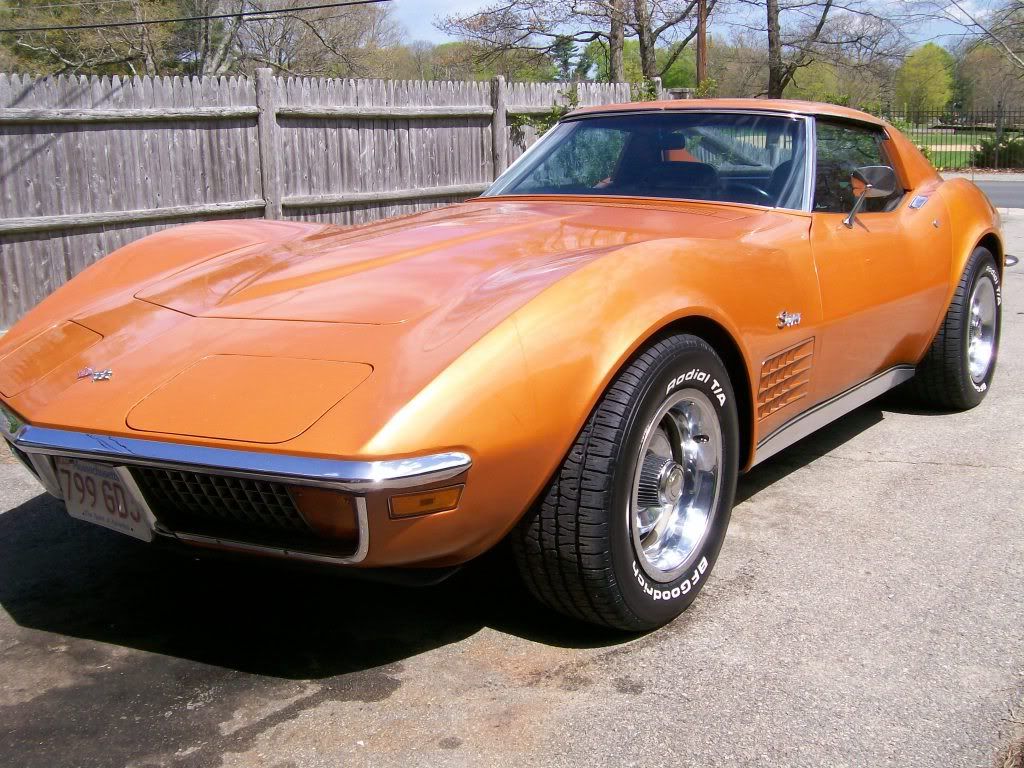

If you install the VB&P Street & Slalom suspension (I think they have changed the name a bit) you will get this:
A lot of the ride height issues are due to either incorrect front spring installation or rear springs that aren't suited for the car.
Rick B.

Thank you for the advice, your cars ride height look nice. Did the rear require longer than stock bolts?
