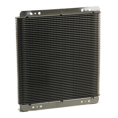

Robb, you have plenty of cooling for your 700R4. Granted that 700Rs are inherently weak and prone to have failures due to heat..since you have the 4l80e stuff in it, you will be good to go...
Just to add to this thread, this is what I am using:
http://www.summitracing.com/parts/BMM-70274/?rtype=10
Mounted laying flat. JUST clears the hood when its open. I already had the AC condensor in front of the radiator so I didnt want to block it.
Air blows through from the bottom:
Over 8k miles on this setup and tons of racing...no problems at all... tranny fluid always looks and smells new.

Originally Posted by RobbSalzmann
Wow, I went from panic to placid over this thread. I made the mistake of choosing not to use the radiator to cool the trans.
My reasoning was that I want the radiator to be dedicated to cooling the 700+ HP small block engine - I don't want the trans to add to that cooling requirement and I expect the engine will still run pretty hot so I don't want the trans cooling limited by the engine.
Now I see my logic is incomplete without mentioning the smoothing effect the efficiency of fluid to fluid heat exchange provides.
The trans is a 700r4 with (a stronger version of) 4L80e internals and a 10" 3200 stall TC.
I'll be running dual B&M 70268 11" X 7½" Super Coolers in series with (2) 9" pusher Spal fans thermostatically switched at 185on/165off. mounted about 1½" in front of the radiator.
¿¿Will this be enough to get the job done?? (I imagine the answer is "It depends") but I'd like to hear you guys weigh in.
ps. MrVette, you are a transmission common sense rockstar(complete with the rockstar hair)!
