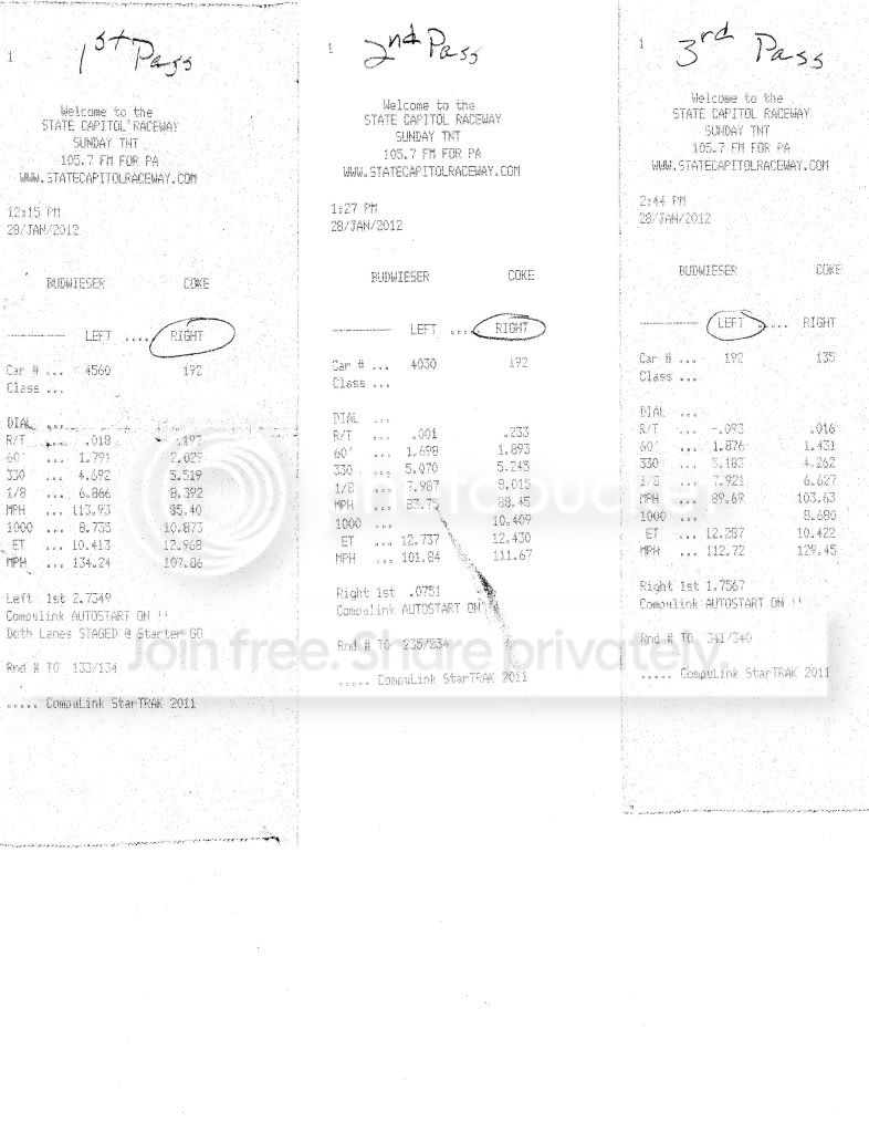

Ran my car yesterday at the drag strip. Best time was 12.283 @ 112.72mph.
Here are my time slips:
[IMG][/IMG]
1st Pass - Left line at 1500rpm, engine hesitated badly when I put it to WOT, then launched. No wheel spin. I also had timing less then 35-degrees just being cautious. Shifted from 1-2 and 2-3 at 5500rpm.
I adjusted the squirter pump on the carb to give me a little more squirt. Set timing to all in of 35-degrees (dyno showed this made max hp).
2nd Pass - Left line at 2000rpm, engine did not hesitate, no wheel spin.
Shifted from 1-2 and 2-3 at 5800rpm.
3rd Pass - Left line at 2500rpm, engine did not hesitate, wheels spun and car got a little sideways leaving the line, shifted from 1-2 and 2-3 at 6000rpm.

Looking for any tips, info, that might help my times. I am a rookie at driving so I definitely need seat time.

Very nice times for your first try! Here's some ideas that might help your consistency, and consistency is what it's all about in bracket racing (BTW, you've got some very quick competition on the tree!):
1. Practice on the tree (a practice device helps)
2. Check rear tire pressure - with 275-50-15 MT ET Streets, I run 18 psi.
3. Do a consistent burnout to clean and warm the tires
4. Pre-load the TQ to the same rpm every time - 2,000 rpm appears good; 2,500 rpm does not since you broke traction.
5. Stage at the same engine temperature every time.
6. IMO, I prefer to hold the car in place on the line with a line-lock to the front wheels only (of a C3) rather than pedal braking to all 4 wheels - the resulting rear wheel torque helps pre-load the rear tires for traction.
7. Practice, practice, practice!

Very respectable numbers for your first time out.
You should be able to get in the 11s at 112 mph. Your 60 ft times are the key. With your tires, you should be able to leave with very little wheelspin. That 3.36 rear isn't helping but as Larry pointed out, tire pressure, burnout technique and rpm level at launch are important. After another three runs, you might chop off a few more tenths. Your 60 ft should be in the 1.6 to 1.7 range. The rule of thum is for every tenth you take off the 60 ft, you take 2 off the ET.
Good luck and report back on your progress.

112 mph seems kind of low for 540hp. I think you need more convertor. What brand convertor are you using?

Thanks for the input. Lots of good advice.
Larry- I was running 25psi in rear tires. I didn't heat them up very much during burnout. My brake pedal is too soft. I do have a line lock installed but am trying to figure out why the soft brake pedal (recently installed new master cylinder, 4-new calipers, and new brake shoes. Have bled brakes several times using all methods (gravity, pumping pedal, vacuum pump, and power bleeder pump). Just ordered new rubber brake hoses. If not that I'll check rotor runout.) Hopefully I can get my brakes fixed by this weekend.
BK - Glad to know what 60ft times I am shooting for. I was hoping to run in high 11's.
Airbus - I am running a PTC street strip converter. I think it's a decent converter. But maybe 3500 stall might be better.
If work doesn't get in the way I'll go racing this weekend. Hopefully at least get 3 trial passes before racing starts.its the first race of the year. There was over 200 cars at the track yesterday for test n tune getting ready. Took 5 hours to make 3 passes.
I'll keep posting my times. Thanks for the help.

I would lower the air pressure and do a medium burnout.Leave at as high of an rpm as you can w/o spinning.You need to 60ft better with your gears.
I prefer leaving off idle and flashing the converter but I have no experience in a C3.

First..congratulations on a good outing! It ran strong...all the pieces are still where they belong and you had a good time! That's a good day racing!
Tell us more about the motor? What's the combo? Heads, cam compression, intake, headers etc? Do you have a dyno sheet we could see to look at the curve?
