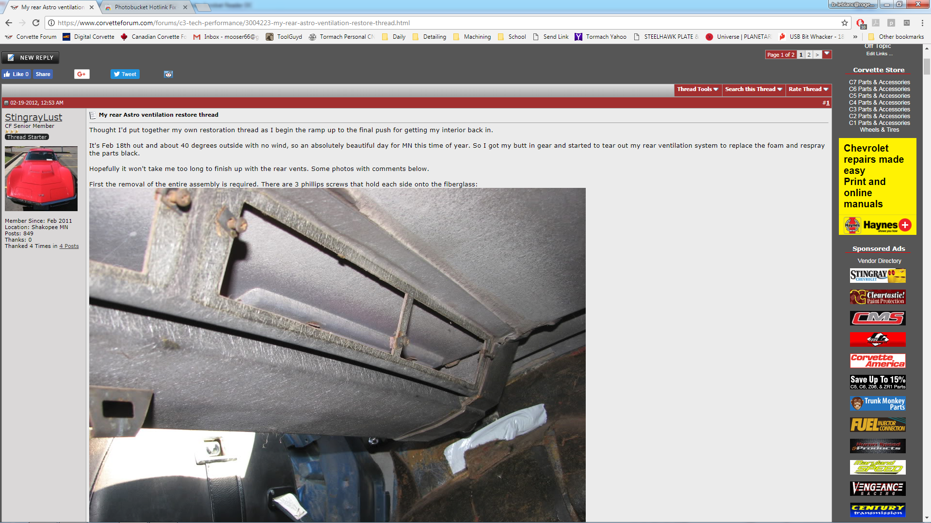

Originally Posted by EarlyC34me
This is the biggest annoyance now when researching a project. I was happy to see this thread because its a to do item but half of the content is gone.
Good luck with the project Bill and sorry i have nothing to add
if you're using google chrome
Search for "Photobucket Hotlink Fix" offered by bridgetroll.io and install it.
Reload the page and it will show the images, for now, until photobucket changes it and makes it note work again
M
