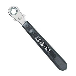

There is a tool http://www.ecklerscorvette.com/side-...-wrench-1.html I wish I could tell you more but my battery is a top mount so I am not sure what you are up against.
Can you fit a box end down there?

You can remove it with a wrench. Or even a pair of pliers on the round part. They make a specific wrench you can pick up at any parts store
