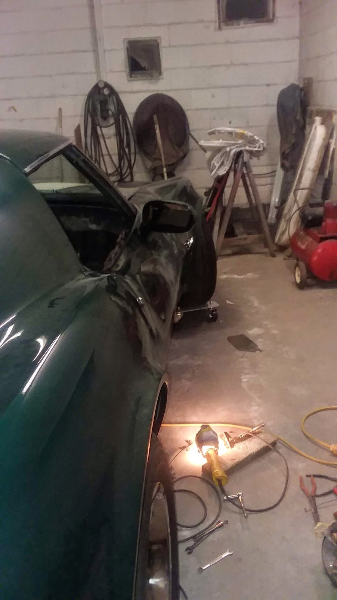

Spoiler alert:Resurrecting an old thread. I finally am getting around to mounting my C5 mirrors and the body work on the car isn't done yet. I mounted the passenger side and it seems to me that it should have gone a few inches further forward, not concerned about covering up the original holes. It seems that the trailing edge of the C5s is about 2 inches further back than the original sport mirrors using the old holes. So the question is, for those of you who have done this mod, are you happy with the placements of the mirrors, or do you have to turn your head a bit more to see out of them? Not a big deal, but since I am drilling holes....

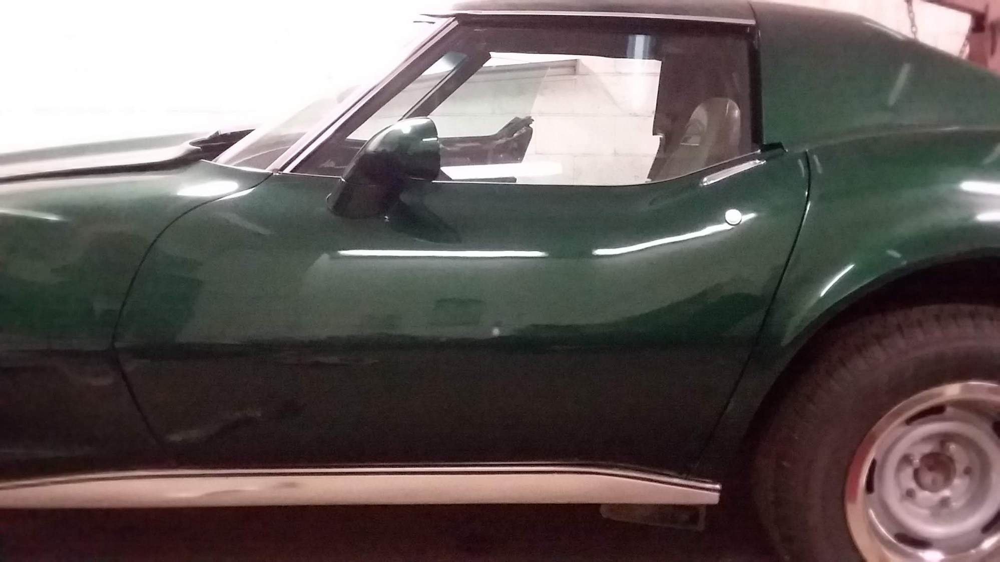

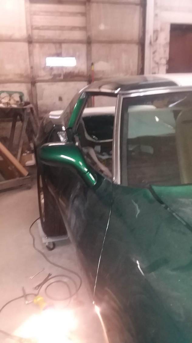

Here's my install so far. (This is my 5 years-and-running-project.) This forum is great. I'm not doing the auto-dimming. Nor do I have the power control hooked up yet. (my idea...not a plan yet..is to put joystick controller in my 74 console/gauge bezel where the fasten seat light is. we'll see how that goes.)
I really like the look!

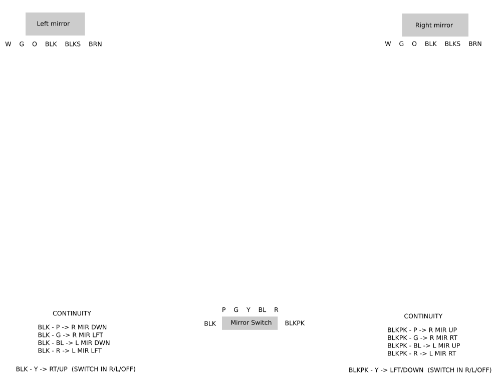

I'm finally getting around to this project since I've had to fix, modify, replace the mirrors on my 76 several times for various reasons. The final straw was a falling branch snapped my passenger mirror off at the ball joint leaving the stem..
I finally found a switch I like and figured out the mirror mounting needs to be moved forwards to put mirror glass in same general spot which I can only reuse one hole. switch location has yet to be determined but probably on the center console somewhere to make wiring easier.. I'm using the standard OEM replacement mirrors for a 05-09 Corvette. The switch is from a Ford 00-03 Escape.
​​​​​​​How many relays? One for just the switch or one for each mirror?
Here is what I've gotten so far with continuity testing. Can any of you wiring geniuses help me out by filling in the blanks?
​​​​​​​Heard a zap ⚡ while trying to figure out the wiring. Now some continuity no longer works.. so I know people have used the GM dorman switch and a smaller ford switch.. anyone happen to know the Ford switch part number and have a wire diagram?
