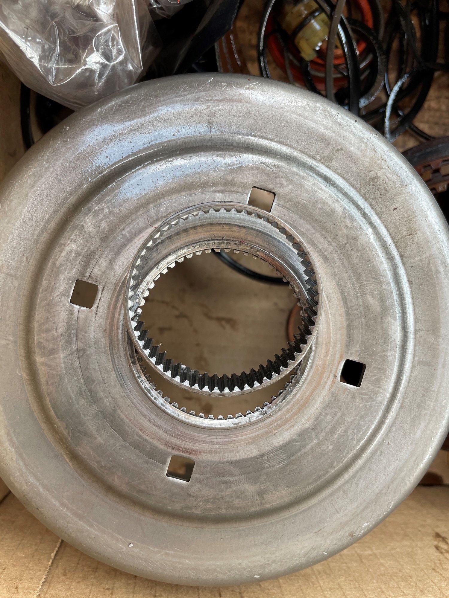

Default The 700R4 Transmission's Hidden Vulnerability
Everything I've read about the "700R4" automatic overdrive transmission originally installed in 100% of our 82's is, on balance overwhelmingly favorable. 82 was the first year of this successful 1980's/early 90's Chevy pickup truck/Corvette transmission. But, mine suddenly bit the dust last week. My wife had actually taken it out to lunch with one of her girlfriends who loves our C3; but, when she returned home and was backing it into our driveway on a slight incline all of a sudden I heard a `bang' noise - at first I thought she had backed into our plastic garbage can(our neighborhood's pick-up day) because that is exactly what it sounded like as I watched her backing up our driveway at ~1MPH - but, she was several yards away from the can and instantly the engine RPM increased because the car completely lost reverse gear. Thankfully, it still had forward gears so I could park it in the garage, but what an expensive bummer.
The owner of the impressive trans rebuild shop (Westland, Mich.) who I had overhaul it said that I couldn't blame my wife for the failure, whatsoever (I knew better, anyway because I witnessed everything), and that he has seen countless 700R4 transmissions which failed because the light/weak weld between the star gear and the trans drum separated. He said it is a long known issue which GM resolved later on in production, but at least the 82's are vulnerable. He mentioned (3) Japanese makes that repeatedly experience the same design fault. He said that they replace it with a new gear/drum unit that is heavily welded that the manufacturer of it calls it "The Beast". Anyway, despite the unexpected $3200 complete trans overhaul I actually feel blessed that the failure happened in my own driveway, especially with my wife involved.... or, that might have caused long term bad karma. I will include the photo/s of the the culprit drum unit showing the detached gear that lost reverse gear hoping this may help a fellow `82 C3 enthusiast brethren
Dave V., Canton MI

Before you put the 700R back together, have a look at the Sonnax Smart Shell vs putting another Beast back in there. The Beast is not hardened or balanced, but it is a little beefier. This is why you hear people talk about a vibration in 3rd gear a lot of the time. I threw a Sonnax Smart Shell complete roller assembly with Torrington bearings in mine a long time ago and it has taken a beaten and keeps on going. I'm sure my 82 is out powering any stock 82. I may pull mine apart and have a look inside to see how things look and do an upgrade or two while in there. GL with your 700R rebuild.
Hey, Tom (Buc), I appreciate - more than you know coming from your respected `82 C3 expertise. Whenever you see me pop in to help others, please jump in as you, reliably do. You are an asset to this Sticky and overall C3 forum.
As far as your valued direction on the reverse gear failure that I recently encountered, I'm obviously too late to the party to change direction by my esteemed/respected trans shop here in the Motor City as the job was completed ahead of my post to hopefully help others. Also, I don't put my C3 through the performance paces as you enjoy. My wife is almost always along for the air in the hair drive to local towns like Ann Arbor, MI for the late lunch/early dinner and good tunes without leaning on it too much, though I understand that the repair is significantly better than the factory original trans since all of the known, original 700R4 design's weak points were recognized and resolved shortly after it was released as GM's breakthrough (better MPG, smoother highway cruising) Chevy Truck/Corvette transmission. Again, thanks - you are a genuine subject matter expert in our favorite hobby!.

Thank you for your comments. The issue with your 700R is somewhat odd for what was going on at the time, but all it takes is a crack in the that shell at the hub and it's just a matter of time before it lets go and you're done. I had a good friend race her 77 vette at the track recently who had a 200R4 in it and it took a beating. She would run 11.50s and with her new setup 11.20s with that car and it launches really hard. The last time she was at the track she said that she did not have reverse and raced it anyway, which I thought was crazy as hell. Anyway, the trans let loose after a really good hit and the shell was destroyed alone with other things. Everyone one thinks that the 200R is much better than the 700R, I don't subscribe to that and think they are just about the same and the 700R has a lower 1st gear as well. It's all about how you build them and what you do with the car. GL and hope you enjoy your 82 even more when out cruising.
