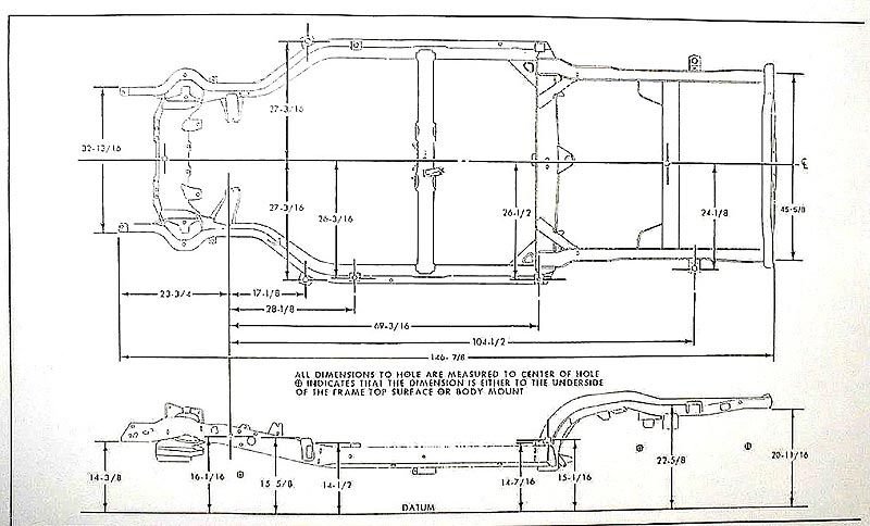

Using four points from the chassis/frame, I used a plumb bob to locate said points to the floor after leveling car. I then found the center line of the four points and transferred that back to the chassis and for future use. While the c/l was still located on floor, I created two parrallel offsets to use in setting the alignment, tracking, & thrust angles.
Here's what I used in addition to a tape measurer fwiw.
