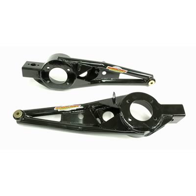

I went with these:
CHEVROLET CORVETTE Global West Suspension Super Duty Rear Control Arms TBC-9
Global West TAs from Tracdogg2
