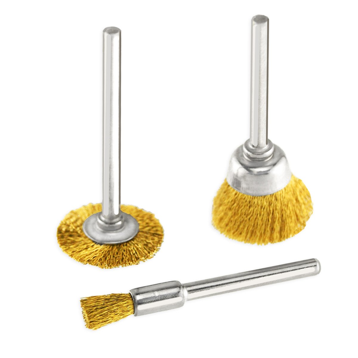

Originally Posted by AirborneSilva
Sorry to break in on this for a question to DUB, what's the best way to clean a fuse box? take all the fuses out get a small wire brush and go to town? I think I need to do a bit of wiring cleaning along with grounds. I really don't have many issues but my flashers wont work and I haven't figured that one out yet, wiring leaves me like this
A fuse box with excessive corrosion is usually a sign of a leaking windshield frame, or a leak somewhere else in the car. I would make sure I have leaks under control.
I like to use a small wire wheel, (the kind with the wires on end not like a regular wire wheel, bottom wire wheel in the pic below) on a "Dremel" tool to clean the contacts... There are other ways to do this.. the small wire wheel seems to work best for me because you can get in the fuse contact area with ease.

I use a similar tubular wire brush like what Willcox has shown in a photo.
I will remove the fuse panel if I am not happy with what I see when cleaning the terminals...and YES...I am brave enough to remove the terminals and clean them with them out of the fuse panel itself. In some cases I replace the terminal with a new one. Usually if there are many terminals "in question" and having "other" problems...the time to try to save the fuse terminals ...along with many other "issues" due to some BOZO getting into the wiring...I suggest to the owner to replace the wiring and start fresh...because...I can not spend hours on a repair that could exceed the cost of replacing a wiring harness with a new one. I balance out the costs and end result.
