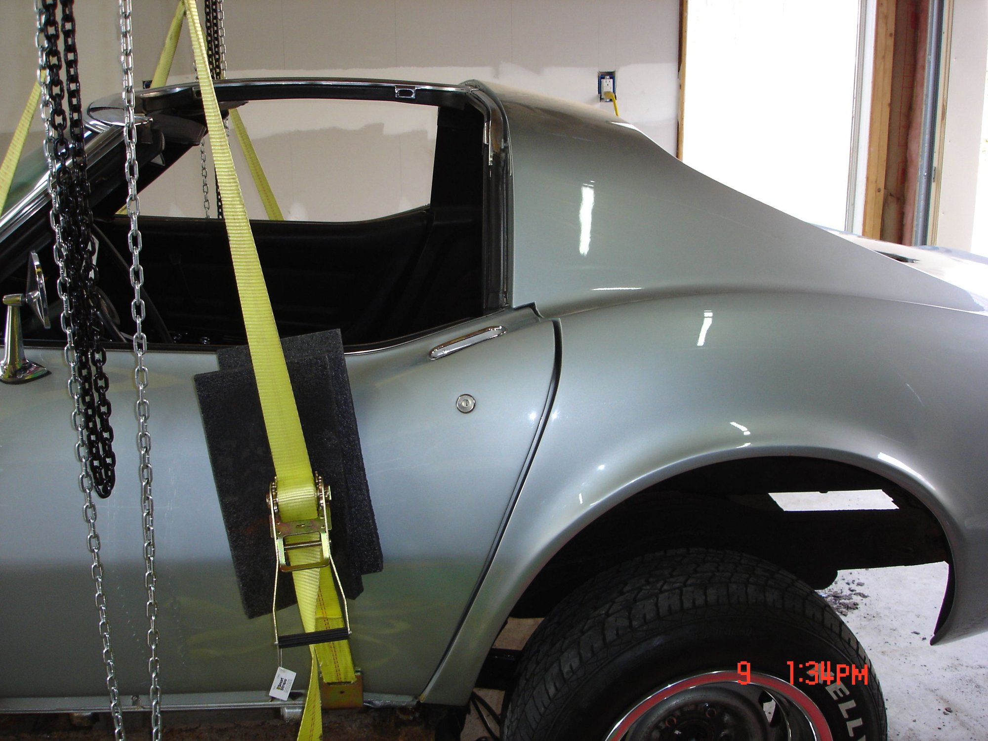

Below are some pics of pulling my '72 body from the chassis a couple months ago. I didn't measure the height of the body when it cleared, but they should give you a feel for the min clearance required. Mine was obviously in the garage nose-in. In addition to the fuel tank, you also have to clear the top of the engine of course no matter what direction you go. Two people rolled the chassis out without any problem.
1... (you can see my father to the right of the pic and he is about 5'11" tall)
2...
3...
