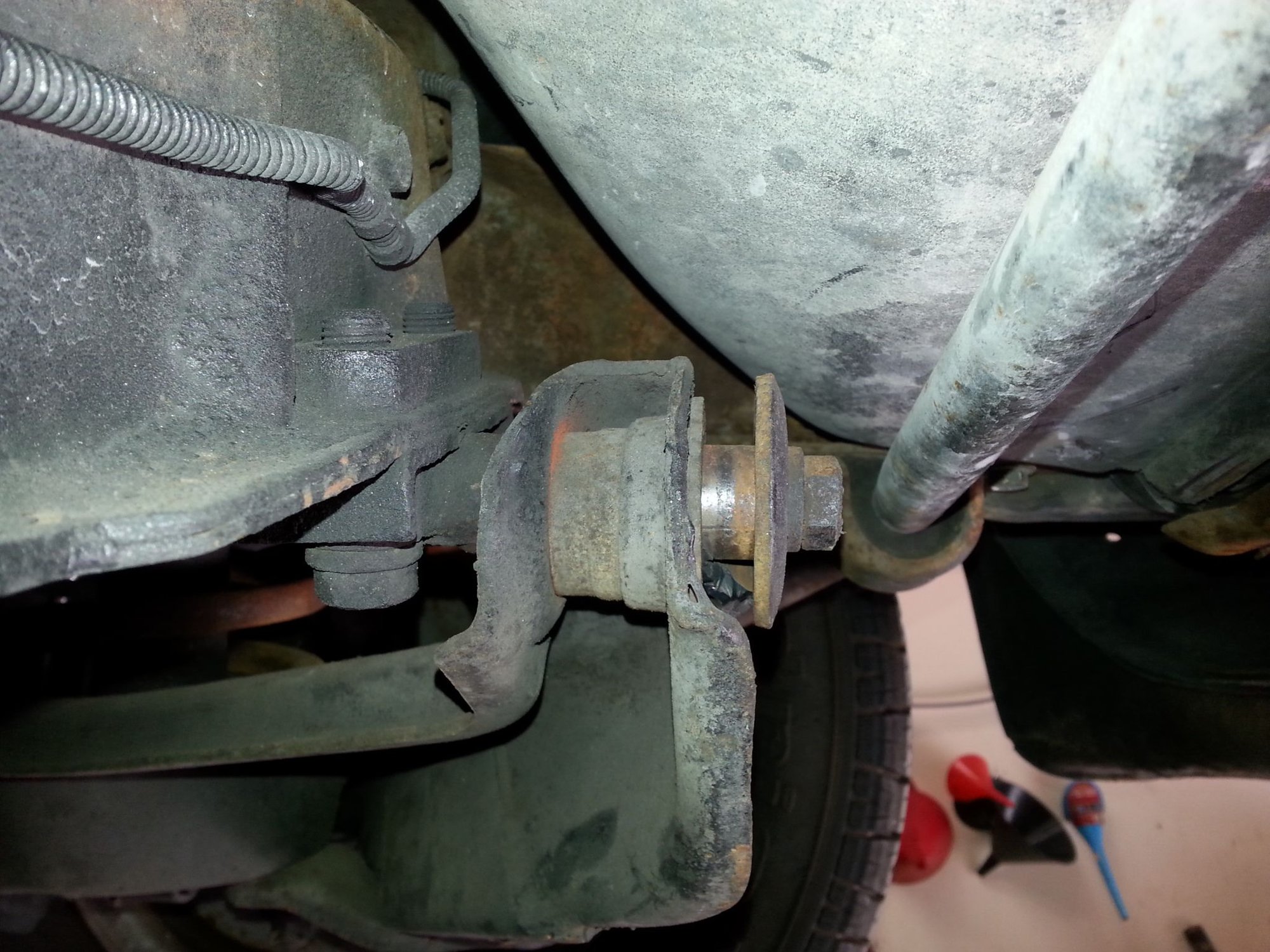

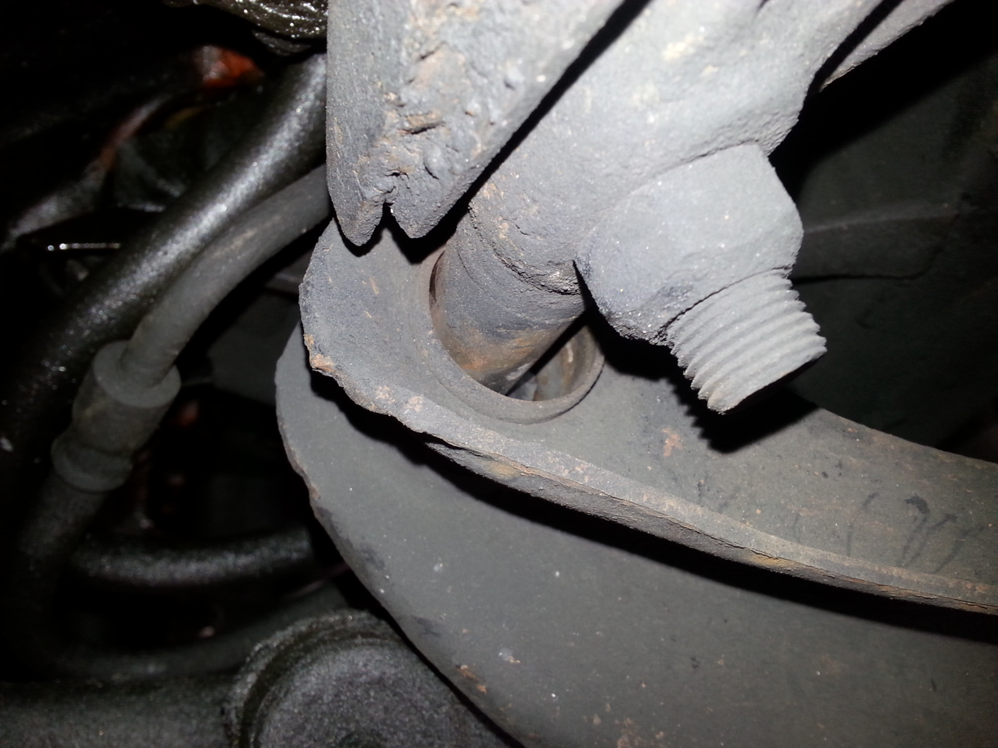

I think I found the problem. I had the car on the lift car and was about to start removing the trailing arms when I decided to check out the front suspension.
The drivers side lower control arm bushings aren't just bad, they're non-existent. Check the pics.
Is it possible for the bushings to get jarred out suddenly? The car drove fine one day then had this problem the next. Granted, the suspension is far from fresh, but I've never seen bushings just vanish.
Rear bushing
Front bushing

Yeah, good catch. I've been following this thread with interest.
Let us know how it handles when replaced.
Don't forget to spray around the garage for those rubber-eating bugs.

good find on the lower bushings. not trying to be a _ss but i thought you said it was just aligned any good tech checks wear points before wasting time setting the thing up???the score groove where the bushing is missing is pretty bad this did not just happen and must make a lot of noise! happy 4th
It was aligned about 6 months ago and the tech would have told me if he saw something wrong. It's driven fine since then. The issue came on suddenly.
I always planned on rebuilding the front end because the components were aged but they were all there. It appears to me that they were more dried out and fragile that I had thought and just crumbled and broke out.
I've ordered a rebuild kit and will update in a few weeks when it's done.
