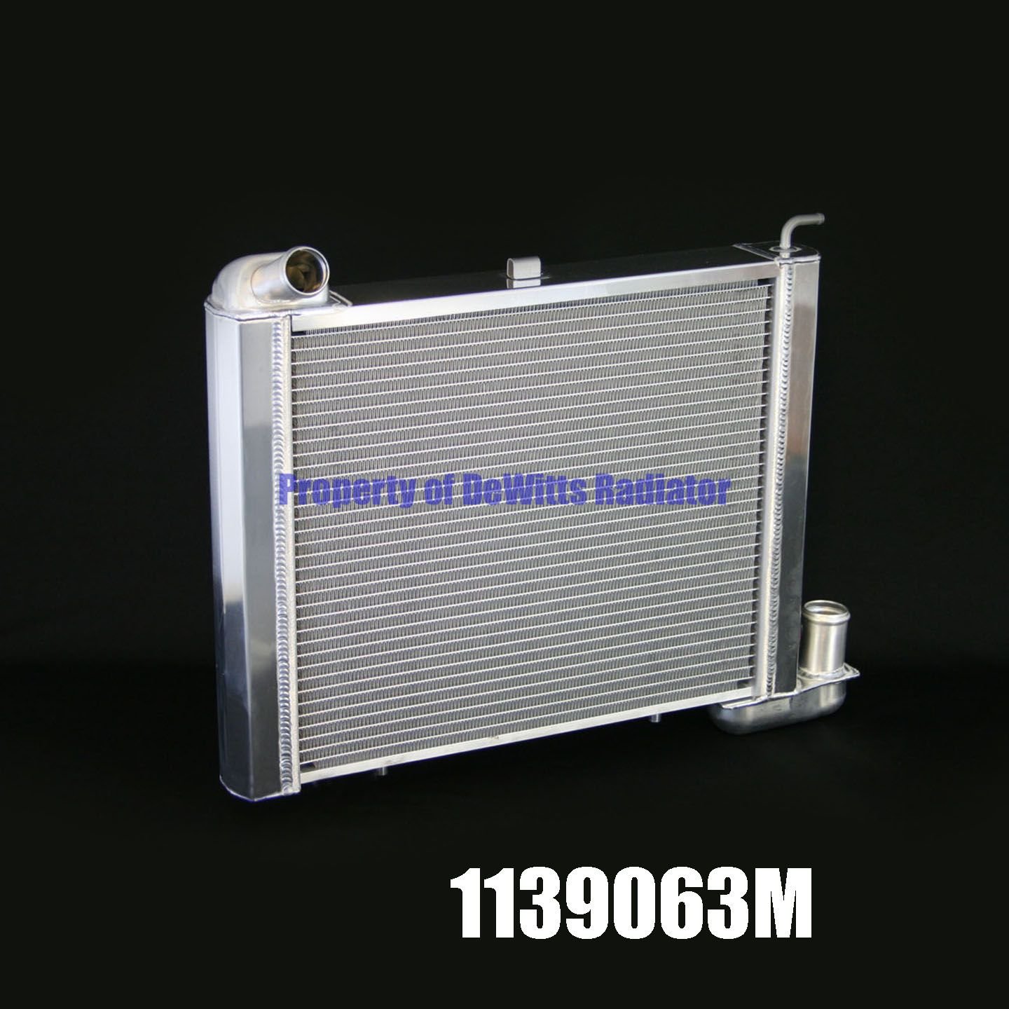

When it comes to C3 radiator threads everyone has to remember there were a lot of changes made in the 15 year run and you have to be model specific when talking about these things.
1968-72 SB model base cars actually came with a factory aluminum radiator that was used during the C2 era. Cars that received any options like automatic changed the radiator to a copper/brass unit.
These two radiators mount completely different and have core supports unique to there own model radiator. This is just two variables for C3 and then you have BB car, SB cars, special rpo engines, surges tanks, manual and automatic transmission.
So when you fire off a comment on someones question, make sure that you are even talking about the same application. With that in mind, my guess with this one is that the small champion was probably for the base car, like this
And the one for the automatic would be this one
Zip sells a version of this radiator without the extruded GM rails for $400
which is not "double" the champion.
http://www.zip-corvette.com/catalog/...category/6762/

Tom,
The problem with the Champion I was shown had smaller (thinner tanks) and it did not have the indentation to accommodate the front sway bar. Even if I was able to get the radiator mounted, I would have had clearance problems with the sway bar. Looking forward to installing my DeWitts.

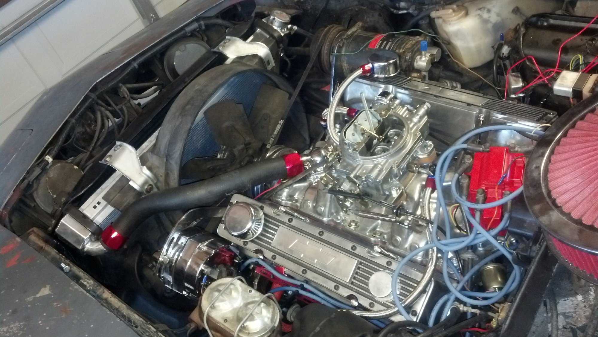

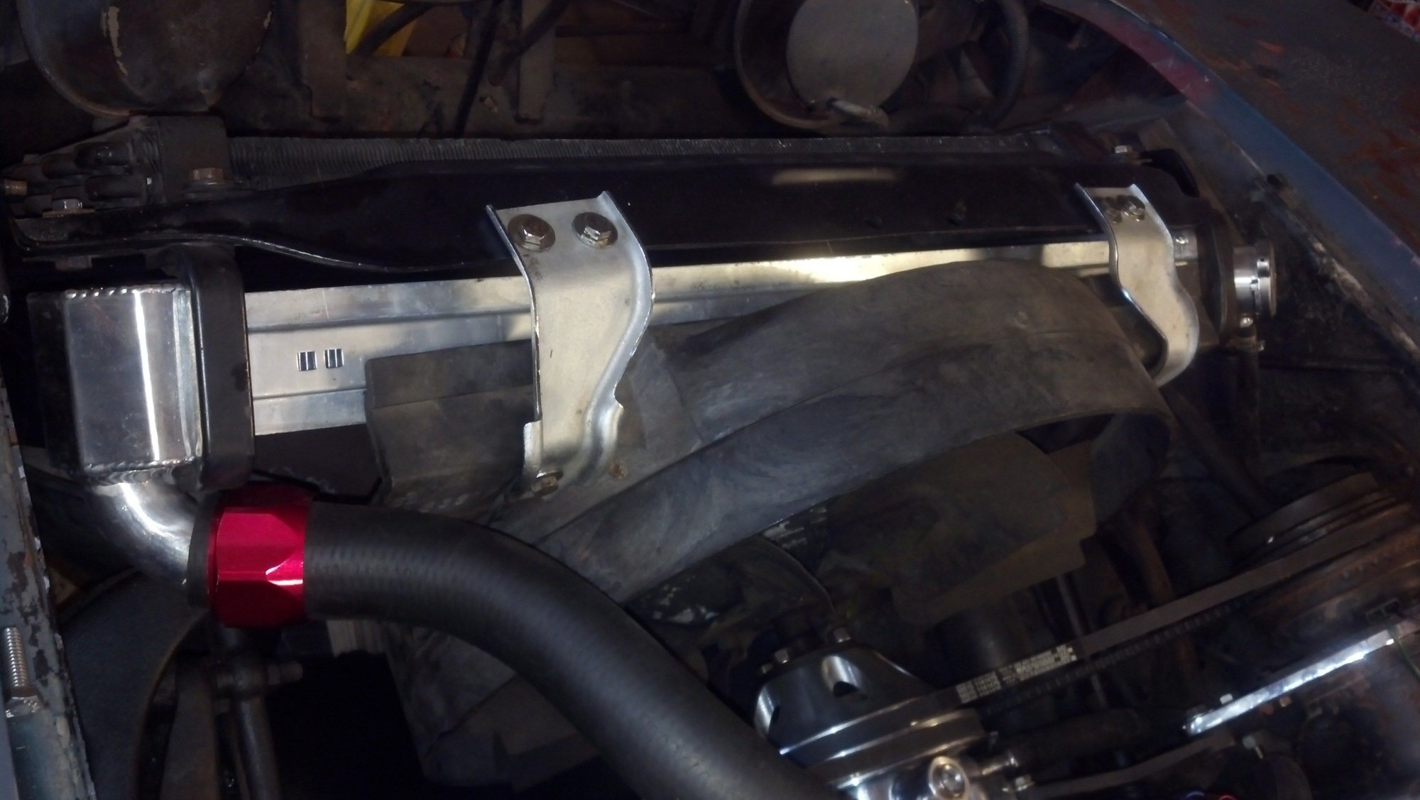

FYI this is how the newer 3 row champion looks and fit for me last week. I had no fitment issues with anything including the lower hose on my 74 auto setup.
