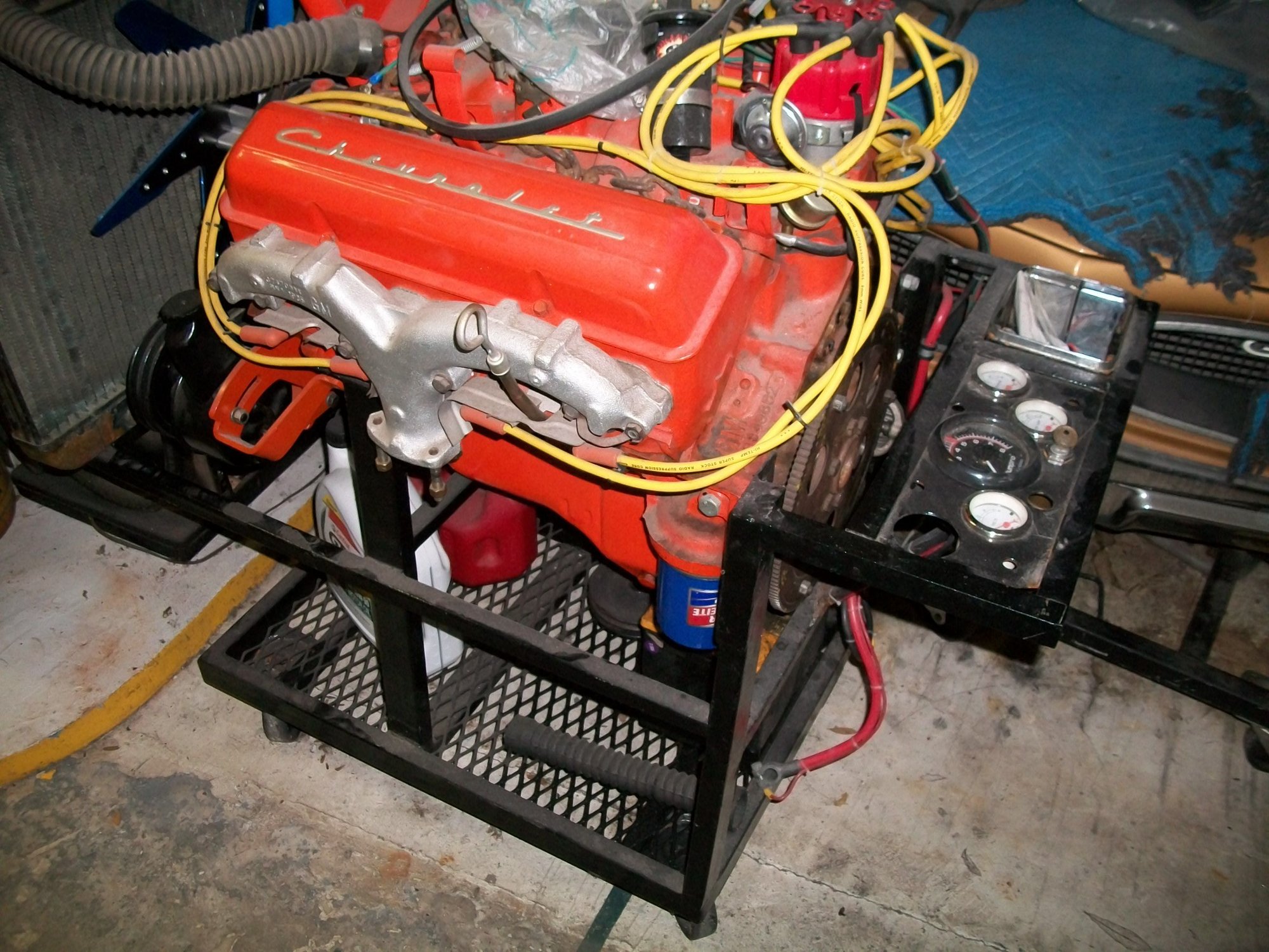

Sorry I don`t have plans, but I built a simple one out of scrap steel we had laying around the garage. After seeing the prices of the fancy ones, I put this together for about $50. Battery sits on the bottom shelf, and gas is fed from a gas can with a hose up to the fuel pump. Gages are wired in, with a key switch for ignition.
