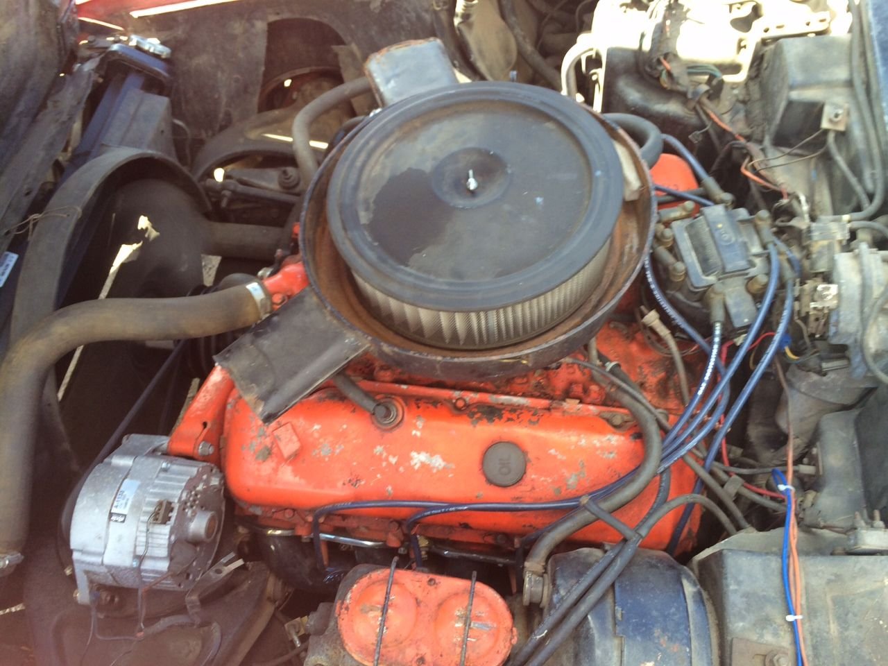

Post a picture of the distributor.

good power = runs well, no backfire or hesitation
Gotcha on the plugs to power not being related.
A little dirty, still sitting on the dealer lot at this point, only pic of dist I have atm.

Is that the speedo cable or mechanical tach cable disconnected by the dist??

Mechanical tach. I have a gauge from a 75 on its way to match the electrical connection on the dist.

That looks to be a bog standard GM HEI. No telling if it's been wired correctly. Run a new wire from the ign. terminal on the fuse panel.
