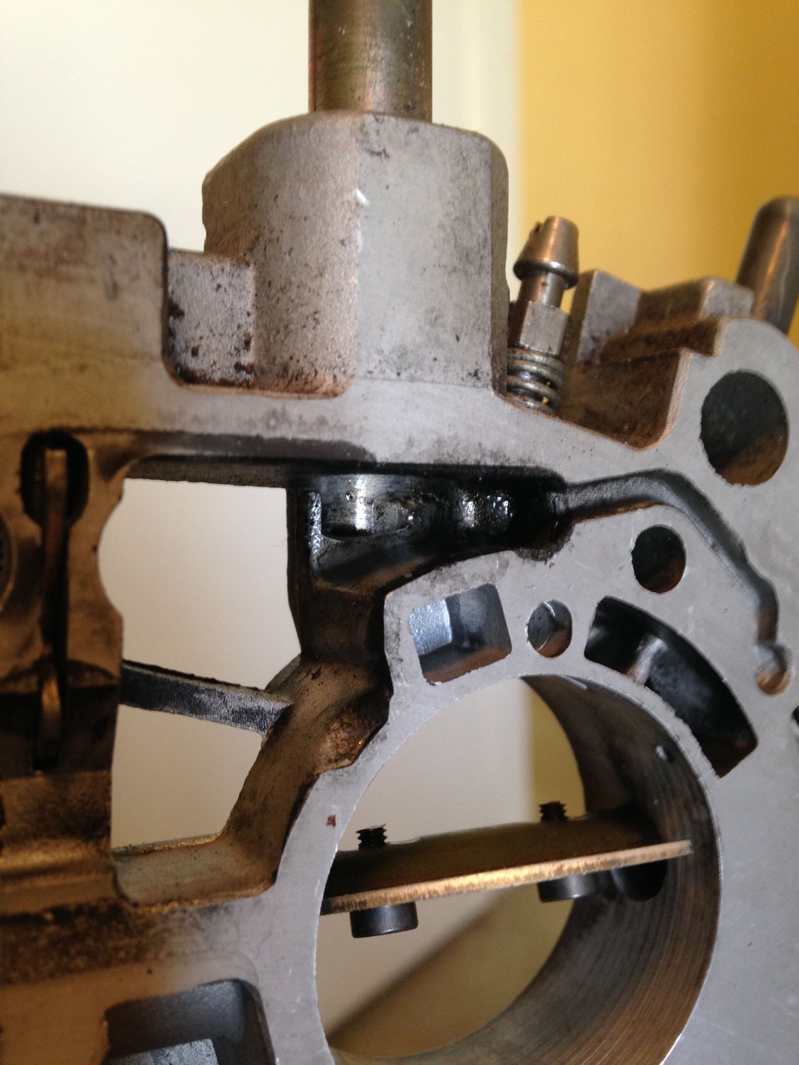

My qjet appears to have cracks that are seeping fuel into the manifold.
Am looking for a decent replacement. It's a R4-4MV for a 73 BBC. It has the divorced choke.I can't see the sense in going to Holley as I would have to forgo my original air cleaner.
The old one had a slightly stripped intake and I was able to fix that but the crack says I would need to dodgy it up with epoxy and I just don't want to go down that path.

Originally Posted by scotto64
Hi all
Tia
I don't see any cracks. Where are the cracks? The only cracks that can seep fuel are cracks in the float bowl - the photo shows the throttle plate. The throttle plate is not a fuel-retaining part of the carb. Are you sure you need a carb..? Any commercially-rebuilt carb you buy will be junk. E-mail me for my paper on commercially built carbs.

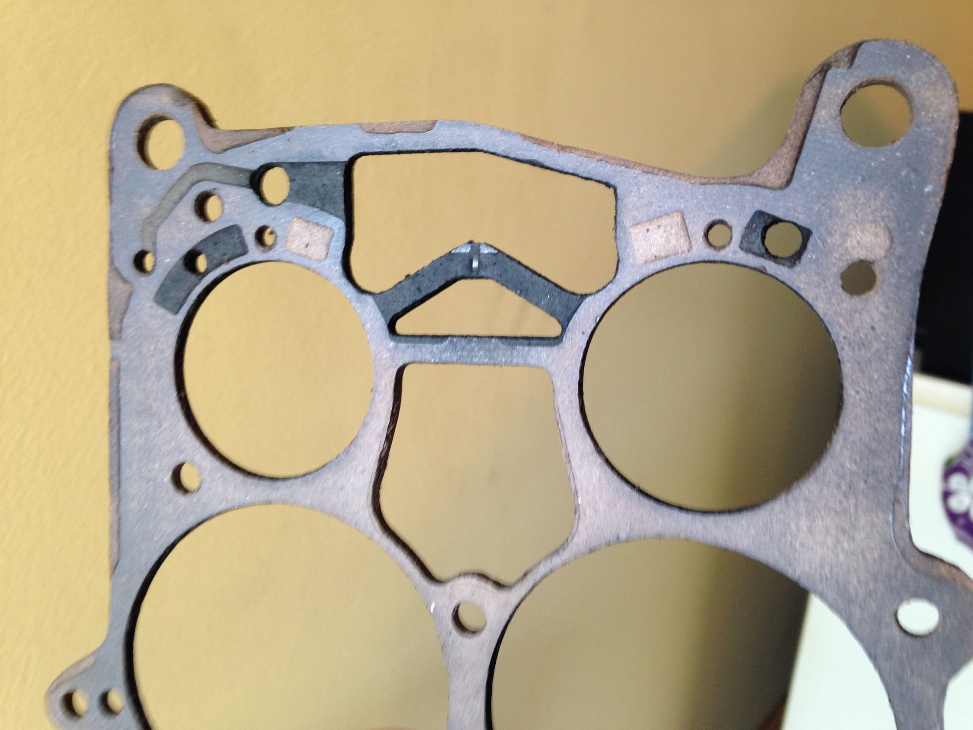

I tested the float bowl as Lars advised (ta mate) and stuff me it didn't drip one bit. Fuel is coming from else where. There is a carbon build up in the inlet manifold directly below the carb, but is clean otherwise. The throttle body gasket is cooked around the primary well plug area. I am not going to reinstall the heat shield as hopefully this leak affair will be fixed.

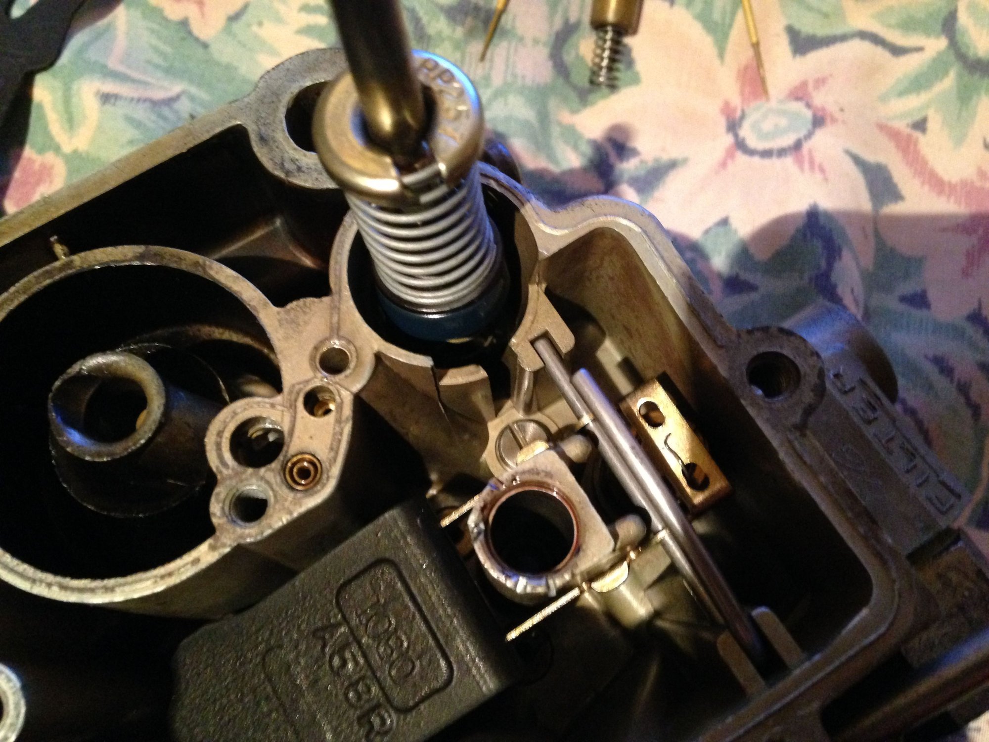

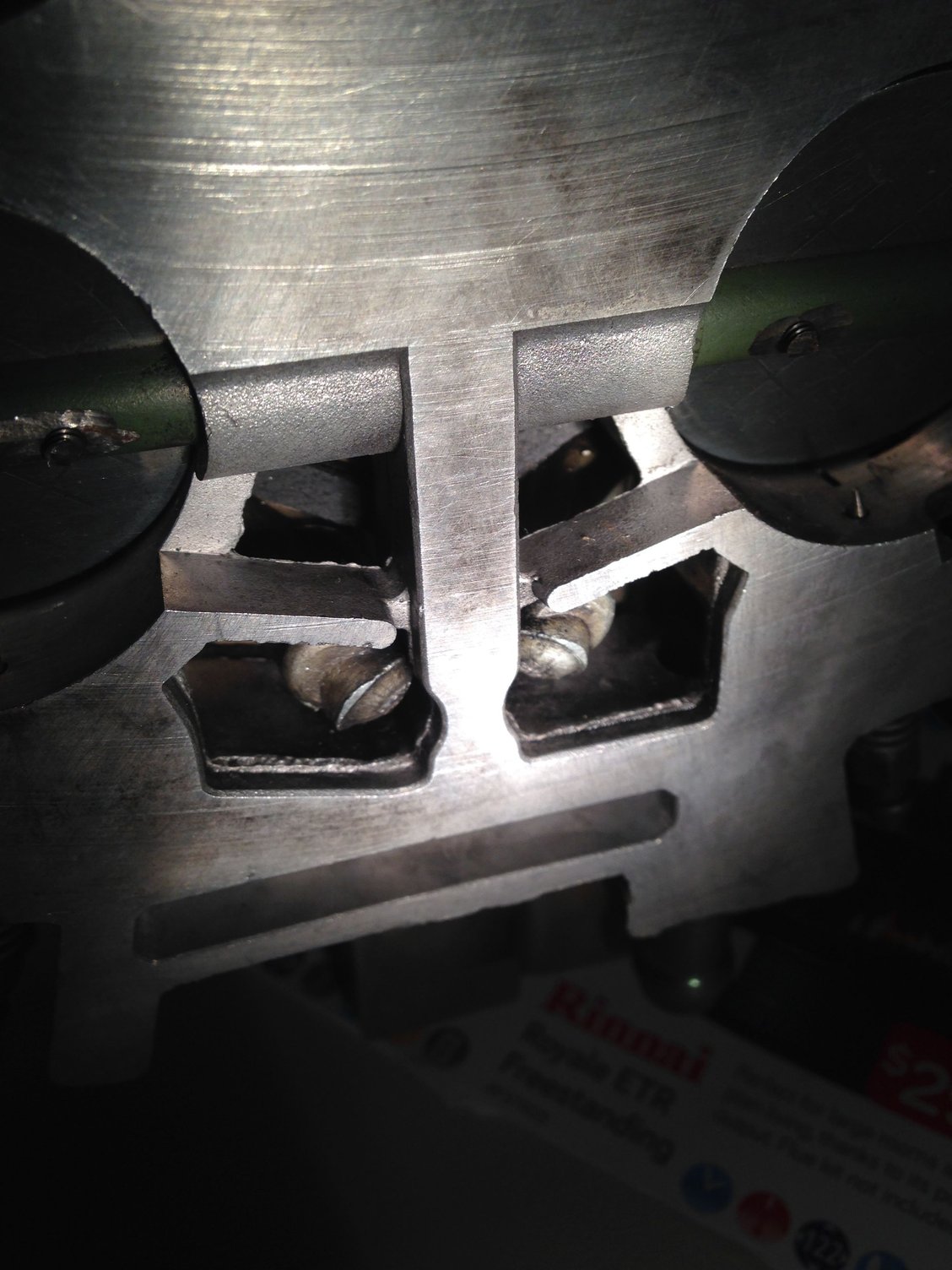

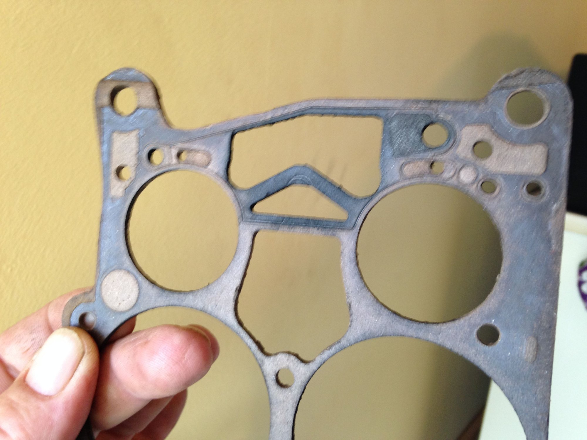

Ok. Another day and night of reading. For anyone with an IQ above 0 minus 50 I would have to say that Lars papers on Qjet tuning are a must. I jumped in at 1am and stripped that puppy down with great expectations. Expectation fulfilled. In a bad way! The air horn was warped to the point where it was hard to find a flat reference point. The float bowl has one corner that is a full 1/4" shorter than the rest of the unit eg, bubba had a mushy flashback and took to it with a hammer. The power piston bush was stuffed. But thats ok coz the top of the power piston tube was munted as someone had taken to it with a screwdriver and hammer (check piccy) Funnily enough, the pump, float and bowl, primaries and secondaries all in new condition. Float was hung thru the hole on the float tho! The gasket was torn around the power piston and rods. Idle pick-up tubes were floating around un attached.
I thought she was running a bit rich!!
