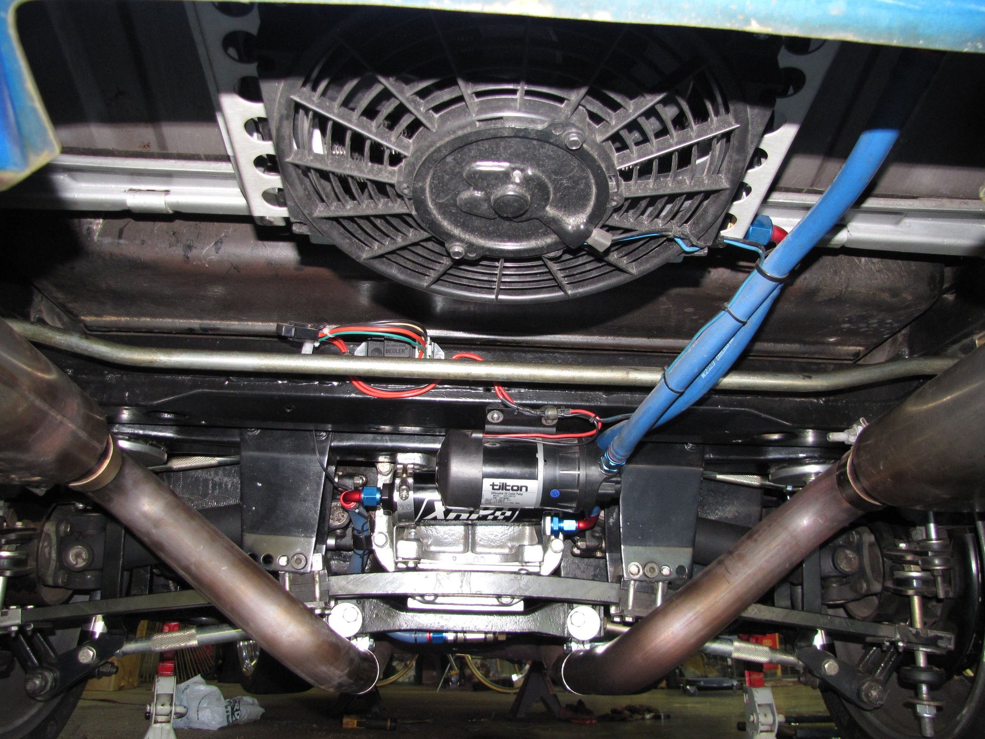

VP&B dual mount front & rear with a Drag Vette 6-link in the rear.
QA1 dual adjustable shocks, Steeroids R&P, Willwood caliphers& rotors. T

What are you cooling with the rear fan?

The differential itself. Had an Auburn center section and after a every track session temp exceeded 300F and the clutches locked up, with gear oil spewing out. I went back to the Eaton center section and put the cooler, pump, filter assy. Temps at 160F now. Also allows for more oil in system 5 quarts total. T
I always considered a rear cooler. My rearend would get so hot that you couldn't touch it for a half hour after a 30 minute event. I went to 85W-140 Valvoline Synpower. It was a 4.11 rear. It now runs much cooler with 3.55 gearing. I only use 2-3-4 gears of my 5 speed. The big jump to .064 OD was too much. Local track I only get up to the mid 150 mph with my 434 ci on the main straight. Miller race track in Utah has a 3000 foot main straight and those crazy Moto GP bikes were doing 208 mph on the main straight. I need to go to an event there.

I used 3 inch aluminum tubing. round on the air side and hose clamped on. The brake side I made more oblong using a vice and then I welded on brackets to hold it onto the caliper mounts. Blowing into the aluminum hats center to flow through the rotors
