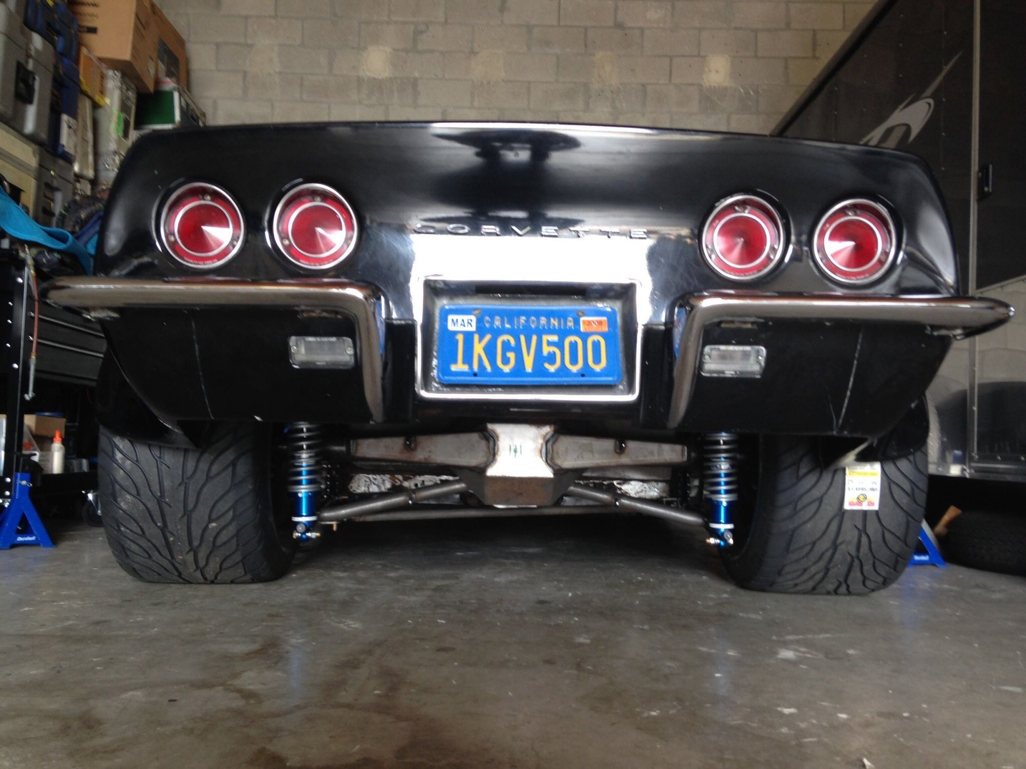

My new fat rear )

Originally Posted by Jamess411
My new fat rear )
Looks sick.
