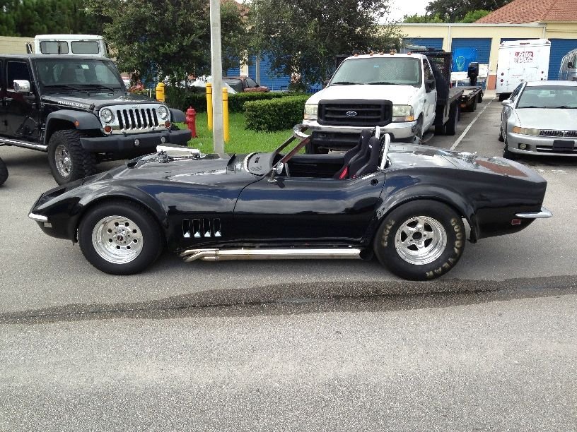

I have a 6-71 with EFI and the hat only sticks out about 4 inches over the L88 hood. Visibility seems unrestricted but I am 6'2" with A4 seats as well.

The engine during the install…still need to finalize wiring before looming them up and mount the gages on the back above the fuel lines to the injectors.
The car is still a work in progress but at least it looks like a car again. The Autofab/Moser M9 rear end kit is waiting at home to be installed in two weeks. Bought some M/T 29x15x15 S/R tires for the rear.
That looks sweet, I asked about your rear diff in the tire section, disregard that. Can you share anything more about your combo?

It is a 420" SB with a 3.875 stroke and 6" rods. Dart Pro 1 215cc heads with a custom ground crower cam made for the blower and engine. The entire thing is studded and roller with a small bore 6-71 sitting on top. I wanted to run pump gas with the boost so decided to go with EFI and Meth injection to control any detonation possibilities under boost and to keep the timing. Everything not ignition related is Holley with a 6A MSD box and coil to light it off. A Holley HP computer is controlling with a Enderle Bug catcher and 8 60lb injectors feeding the engine. I figured out that the engine only needed 1050 CFM of air at 6500 rpm and 7 lbs of boost so I welded two block off plates inside the hat to make only one of the butterflies actually allow air in. One section allows 1090 cfm not allowing for the extra ram air pressure of the car moving at speed so I think I will be good. If it seems restricted at all I can just drill a couple small holes in the plates to flow more air later on.
There is still a ton of work and adjustments to make before any actual driving will be done and I like the journey and all the new stuff I am learning during the build.
When I get back home in two weeks I can install the rear and new HUGE rear tires to see if my measuring will result in the look that I want. There might have to be some reshaping of the rear flares to line up with the tire stance perfectly but that is a ways down the road.
