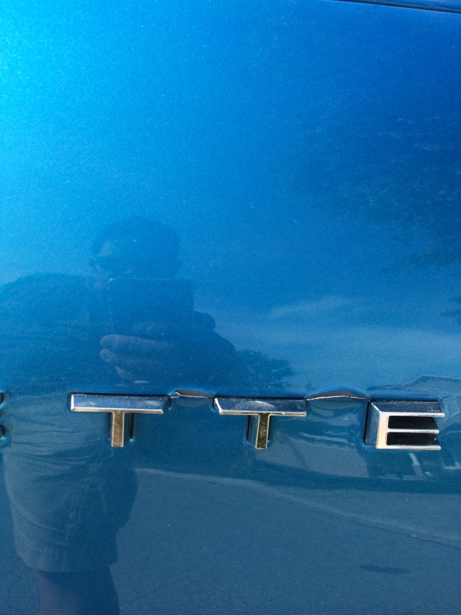

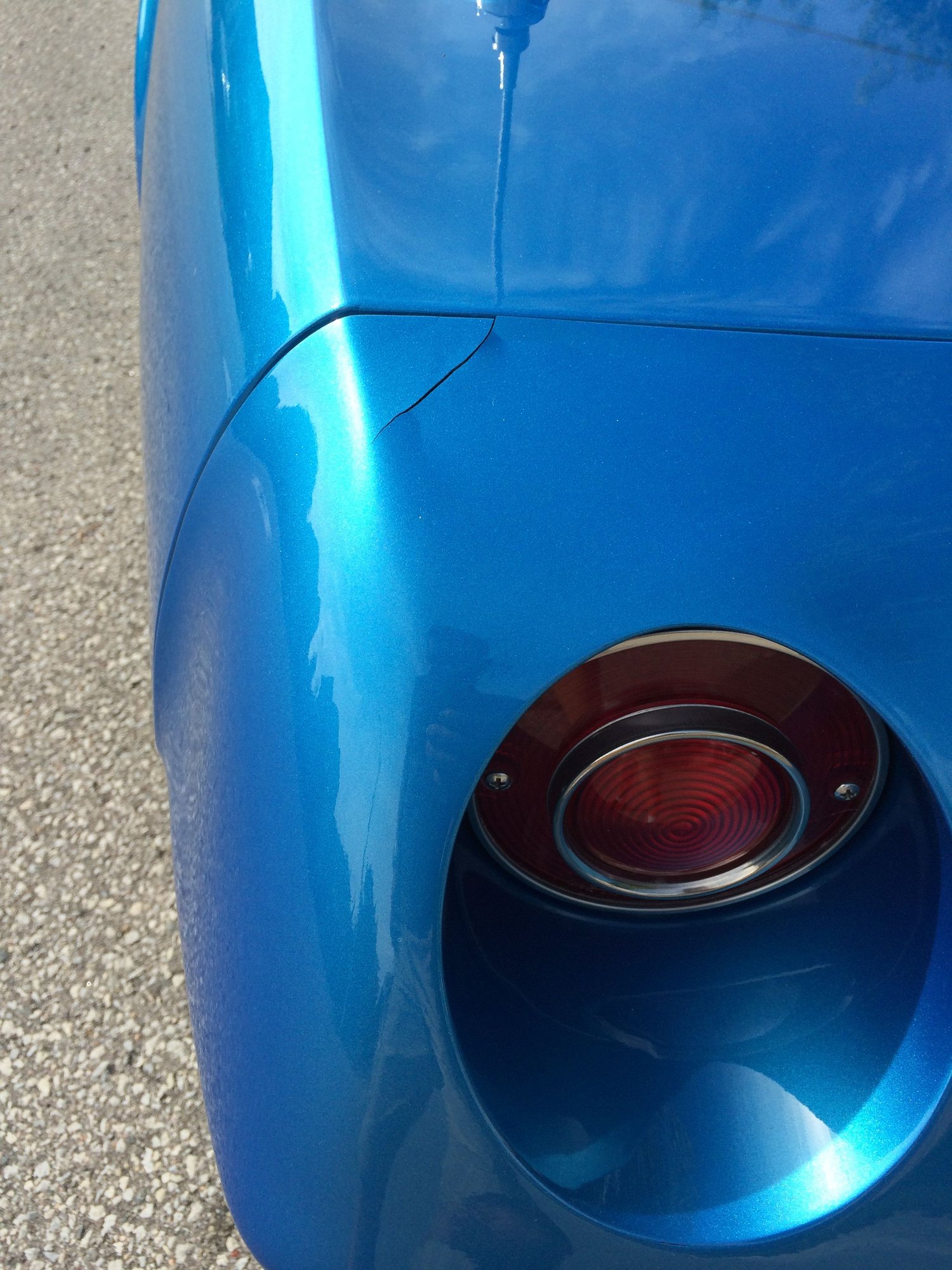

Hi Gang. Had my car repainted 3 years ago. Paint on the bumpers cracked near corners and letters. It's been redone already, so I have no faith in this Painter to fix. Seems to lift the primer right off the urethane bumper too (I can see the black plastic). Happened on the front bumper too and during our extreme change in temperature (I'm in Toronto Canada). I know "I get what I paid for" but this is a shame after restoring the car. The paint is fresh enough that new painter can match.
Can any Canadian members recommend a reasonable shop to fix this job? I've already spent way more than I probably should have, but my family loves this car. Thanks.

Definitely an adhesion problem,wrong product or careless application.My paint on the bumpers does get minor cracks after a while,but the primer and paint never lift like that.

Your 1st and 3rd pictures appear to be showing an actual crack in the bumper. Is that in fact a crack in the urethane bumper? Is the bumper original to the car? Is the paint original or has it be repainted?
Good luck... GUSTO
Opps... reread your post and see it has had a recent repaint.

Hi Gusto, They may look like cracks in the bumper, but they are not. That's only the paint (and some places with primer) cracked and lifted off the urethane bumper. The Painter I used blamed it on the original painter (unknown from maybe 10-20 years ago) for not using the right primer. Painter I used also said it was impossible to sand the paint right down to the bumper, because it would just eat into the urethane 'cause it is so soft.

That my be true, but I do know we have soda-blasted urethane bumpers through layers of paint and had no difficulty, either damaging the bumper or getting good adhesion.
Considering how urethane does age over time from exposure to UV as well as the solvents involved every time they get painted, it may just be time to consider starting with new bumpers, urethane or otherwise. The original front bumper on my '73 was gone by the early 90's. It literally had the consistency of a chocolate bar. You could pull chunks off as you would a chocolate bar.

I have heard more than one professional body guy comment that the new base/clear paints may not be compatible with the old urethane bumpers. Either the paint doesn't stick, or, the bumper becomes very brittle due to the chemicals in it.

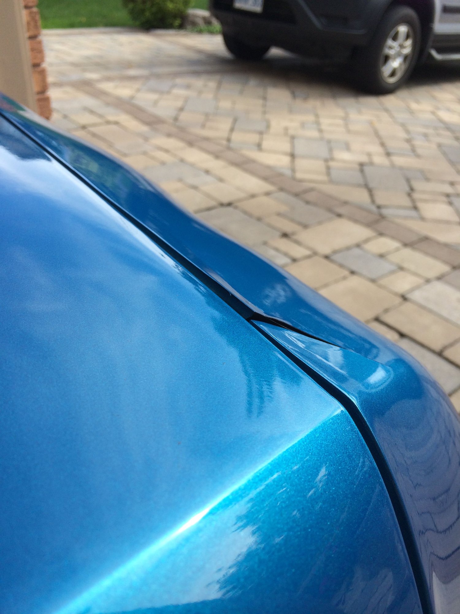

That is a `75 bumper made of the black urethane rubber. They get very brittle with age, and that one is toast. The only way you are ever going to fix the problem is to replace the bumper.

The 73-75 urethane bumpers, are known to become brittle with age and crack, split and break apart. If that's an original 75 bumper, it's lived a lot longer than most of them! The first and third pictures, sure look like an original urethane bumper, that's starting to split and break.
The shot of the paint around the letters, does look like a paint issue though. It reminds me of how old lacquer paint jobs looked, when the paint was put on too heavy. You said that the painter didn't want to strip the bumper, so this could be what's going on there.
Normally a flex agent was used, when painting urethane parts. This allowed the paint to give a little, when the urethane panel "flexed". If the flex agent was left out, and someone pushed on the bumper, in the area of the rear letters, it may have caused the cracking.
No matter what the issue with the paint is, I suspect your problems go deeper. If that is a crack in the urethane, above the tail lamp, then it's time for a new bumper.

Unfortunately the early bumper covers were not very stable, and they get very brittle with age. I have had customers buy NOS covers and try to install them and they crack while installing them. I tried to install a NOS 74 bumper cover about 3 months ago. We had to throw it away. You could not sand it without cracking it. He bought it 15 years ago. A $1600 lesson for him. So for those purest out there that think they may find an NOS one, think again.
I am surprised that one has lasted anywhere close to this long in Canada. You might want to look under there and see if it is, in fact, an original. I know you say it is paint lifting and not a crack, and I will let you determine that for sure, but it is in the most common place for a rubber crack.

You may be the only one that hasn't had to replace their original cover! My original Canadian, 45,000 mile bumper cover was swept up in little pieces off of the body shop floor this spring. It was the 2 coats of paint holding it together!

Thanks for all the feedback guys. The bumper is not cracked (I know it looks as though it is). That's just the paint split and lifting off the bumper (no adhesion). I guess no one's recommending one more repaint at a better or more experienced shop?
