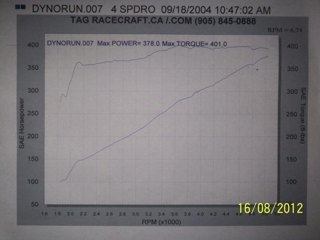

The bigger head and cam and you lose bottom end is just a fairy tale, but keeps coming up again and again like a bad dream. I built a 406ci 10 years.
It had Eldebrock Vic Jr heads measured to 219cc's and a XR280R solid roller with a Vic Jr single plane and a 825 Drag Race Demon to top it off.
These parts according to out "new experts" are way to big for a 406ci I would be losing the cruicial low end grunt for driving around town.
Against all the new "small cam, small heads" posts recently this motor should be a dog down low. I knew different and this is not what happened. I got a nice easy to drive on the street engine with gobs of low end torque over 350 ft/lbs at the wheels @ 2100RPM and the torque curve is flat across the board with max torque @ 3600RPM.
The proof is in the puddin' in the graph below, (stopped early from a sensor problem. I don't think anyone can say this would not be a killer street engine and you take it to the track and run good numbers. The best of both worlds here for sure and for some reason I never even thought about putting a smaller cam and smaller heads on it to make more power
My new 427 is the same with a tad more power
So we correct your numbers with 20% for being on a chassis dyno and we come up with th 473HP and 502#/ft torque.
The AFR190 headed 406 with a hyd roller that is 237/243 .548/537" lift on a 108 makes 519HP at 5800 and 547#/ft at 3800 to 4000 rpm. On a chassis this would be 415HP and 437.6#/ft
Thank you for the dyno sheet.

Peak power was 550HP and 510TQ when I took the engine out and put it on a engine dyno. At the time as most forum members remember( 8 years or so before you showed up) I did this to find the loss between gross and wheel HP and Tq. and the percentage I got was 23 percent, you do the math now, I always have videos and dyno sheets to back up what I say.
This was also 10 years ago and I did not have the money for AFR heads but if I did I would have made more power. AFR 195's now flow about what my "huge" runner Vic jrs. flow Do you get any work done or work just kinda a hobbie and losing arguments on the internet your major activity
So with a baby hyd roller and smaller heads, the engine Chris posted makes 37 more #/ft torque, probably more average power and would smoke your engine on the street in a 3500# car.
LOL...great argument.
How much compression was your 406? I would be embarrassed with those parts and those numbers but hey, to each their own.
10:1 run on 91 Octane same as my 600+HP 427ci. Two against one, no fair, and a my $%@ is bigger that yours childish way of trying to debate a subject and a great way to represent your company, I am sure others will be impressed
IF it made 550/510 and difference between was 23% then it should make 423RWHP and 393RWTQ.
Actually you stated Big heads Big Cam Big.....is the way to go. I'm trying to follow this path of thinking.
How does your 427 compare to Mr. Paul's dyno sheet. You say 600+ and you always dyno your engines. I would be interested in seeing the combination.
You said down low as a comparison that this thing hangs there. Your engine torque wise looks about 365#/ft at 3000 rpm. If we use your conversion of 23% to FW that is 474#/ft. The 406 with he hyd roller makes 511#/ft. That is 37# more in a very usable rpm for a street car when you want to punch it.
