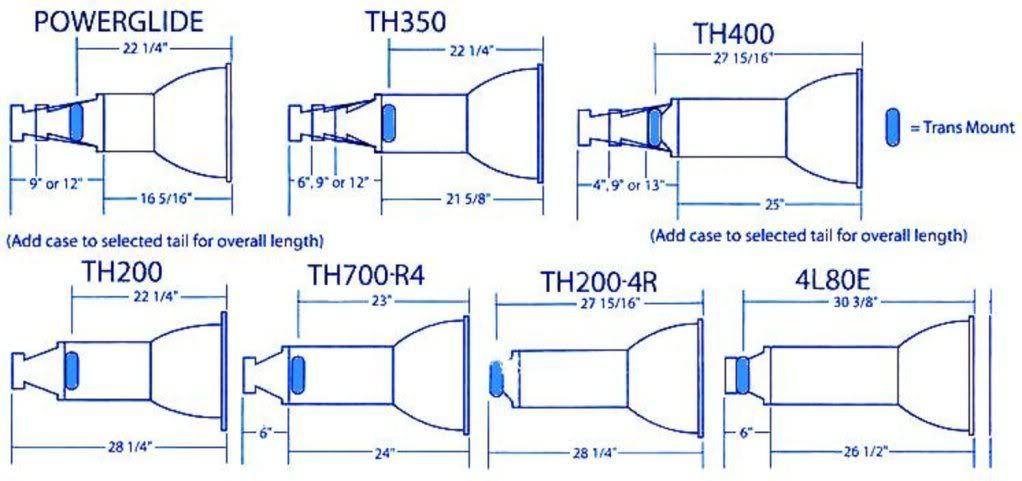

The Corvette used the "short" tail housing. Here is a helpful pic:
That being said, since you are looking to change, make the switch to a manual 5 or 6 spd....you won't regret it. Costly, I know, but well worth it. So glad I did it to my vette. Also, your RWHP numbers will be higher!

I've read recently that in a c3 the driveshaft may be too short with a GV in place. Have to clearance the tunnel as well. I'm curious to see if you decide to do it. I installed one on my old '98 Trans Am-it's a trick piece.

Nice chart. Good info.

Great chart ! No manual for me I am an automatic guy to the end !
