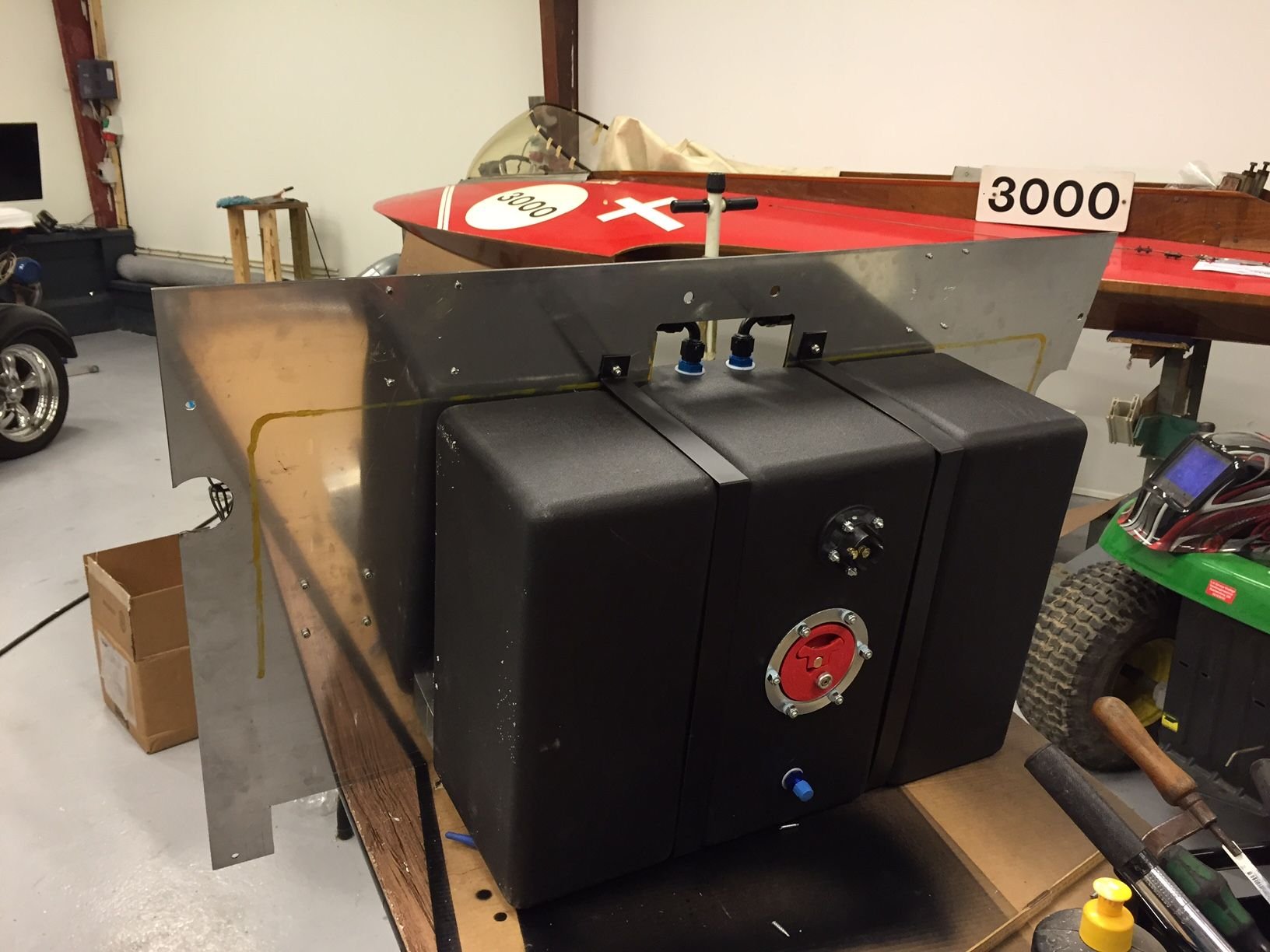

Fuel cell pump filter ,almost complete, the intercooler pump missing
If anyone has any idea to do it better or if I'm doing something wrong .... please tell

Wow what a nice idea for the plastic cell. Very cool.
The only thing I would say is that you really dont want those sharp 90 and 180 degree bends in your supply lines-especially back by the sump and also do your pumps need to be lower than the sump fittings? You may want to check your install instructions on that.
I only have the one pump and feed-Weldon pumps can pull fuel up so its ok for my install.
Thanks i tray this first if i have problens with " fuel " i know whare to look

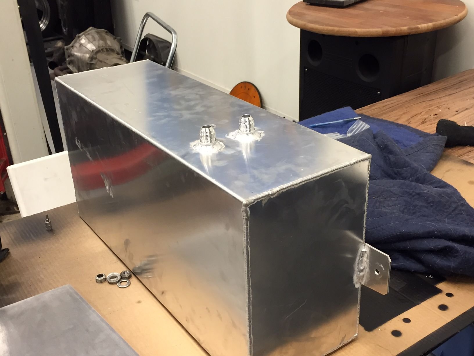

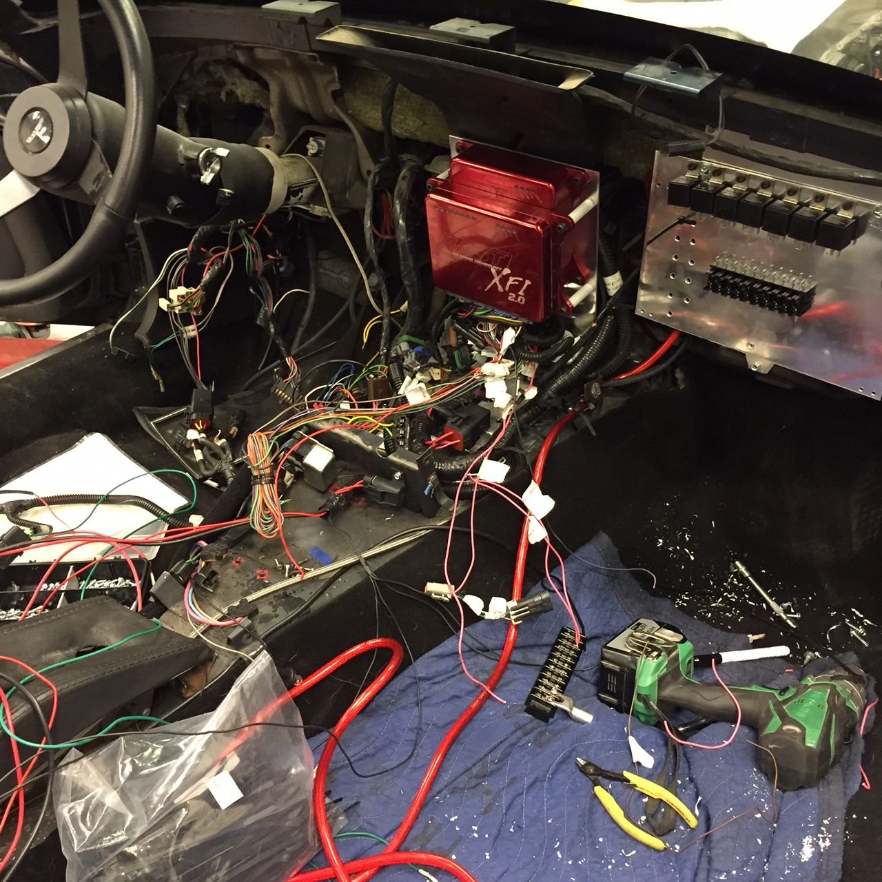

watertank for intercooler -relays for pumps, engine ....
Fast XFI
