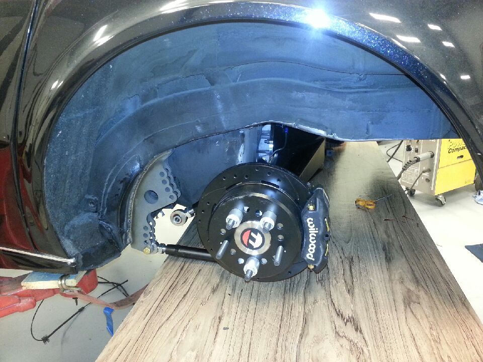

Looks great. Did you have to rework the tunnel and or floor to fit it?
We need details, what class you gonna run, how fast you shooting for, and what motor and tranny?

Nice so far. The 4 nuts and bolts coming through the rear compartment area in the 2nd pic looks to be bolting down a nitrous bottle bracket to me. I see the roll bar welded to the frame in the first pic, Not to mention the th400 trans with an sfi approved bell housing sitting on the floor. Hmmmmmmmmm

From the pics it looks like you are still a ways away from the car sitting right and the tires fitting right also. What are your plans?
Also how did you mount those rear shocks-I cant see the brackets or bolts-did you go through the frame and bolt from up top?

hI Yes i did go through the frame to get it 1 " higther up !
Engine ls 9 ported heads other cam 15 psi boost bigger intercooler nitrous, transmission " lentech " ford AOD .... FAST XFI
i will post more pic when i asamble it ... littel by littel...
Brian

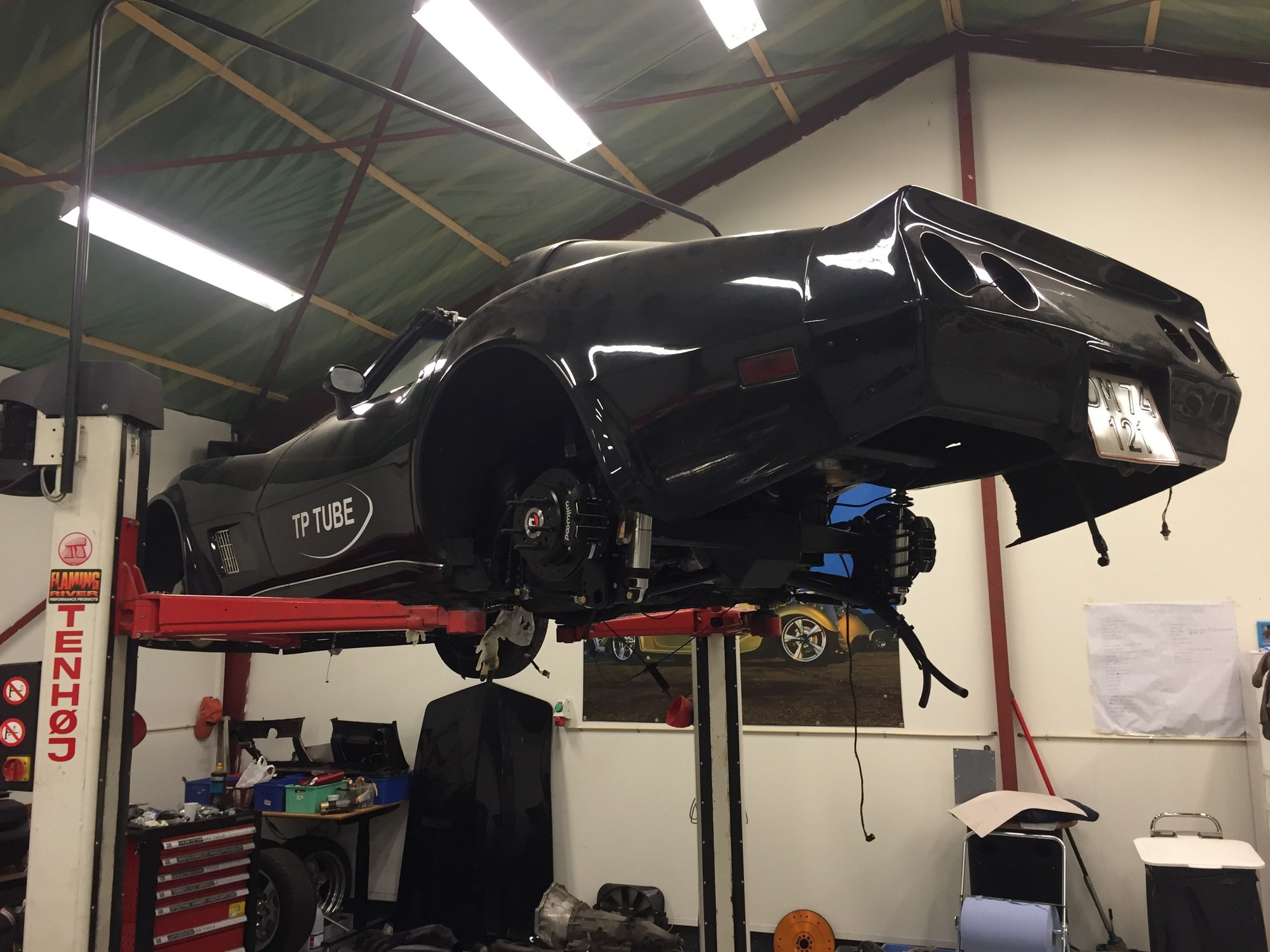

And the" tunnel do NOT fit have to do a lot of fiber work....
Transmission gears 3.50 hope it is ok ! ? i had 3.73 before but it ran out 300m out !...

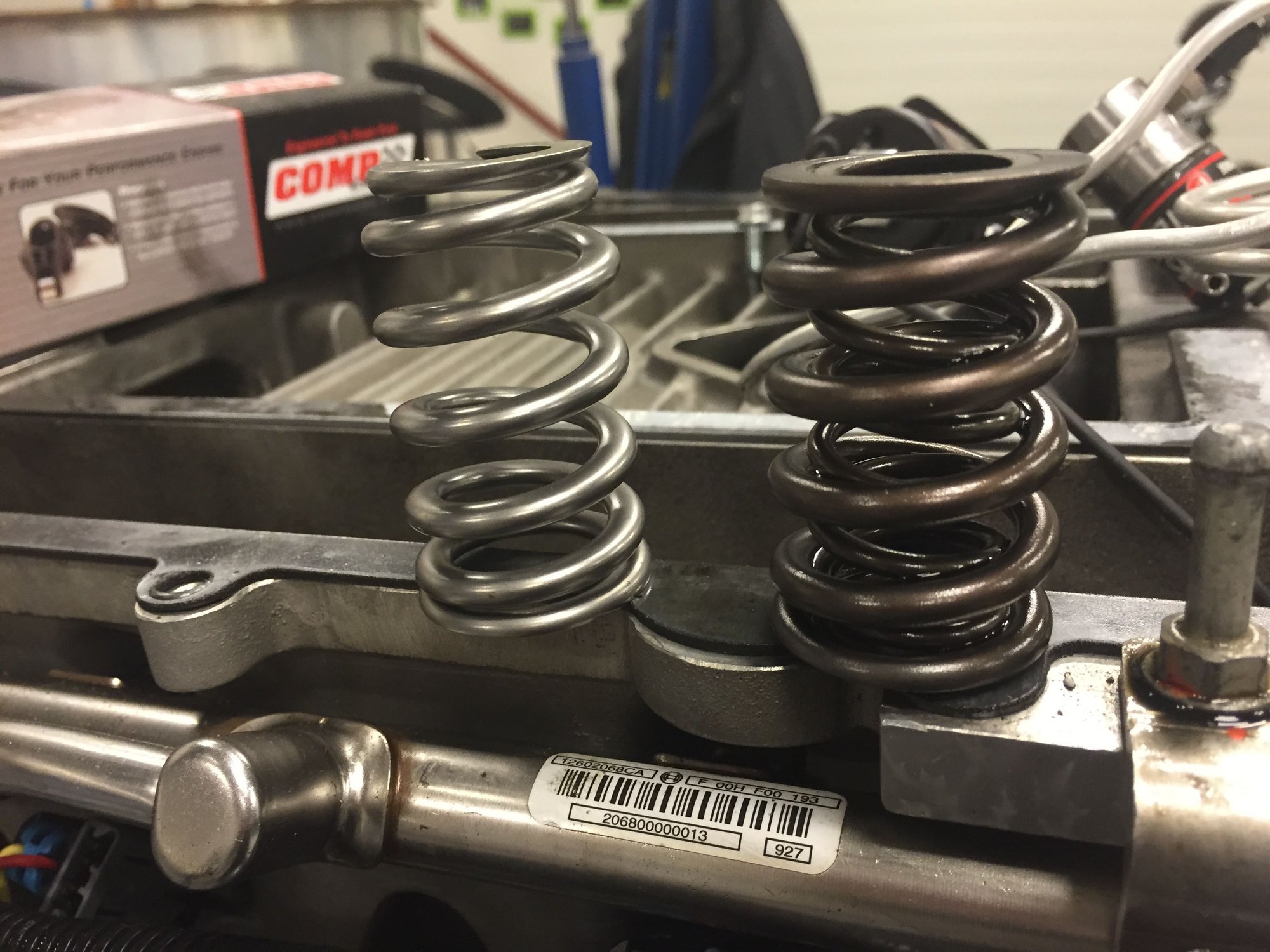

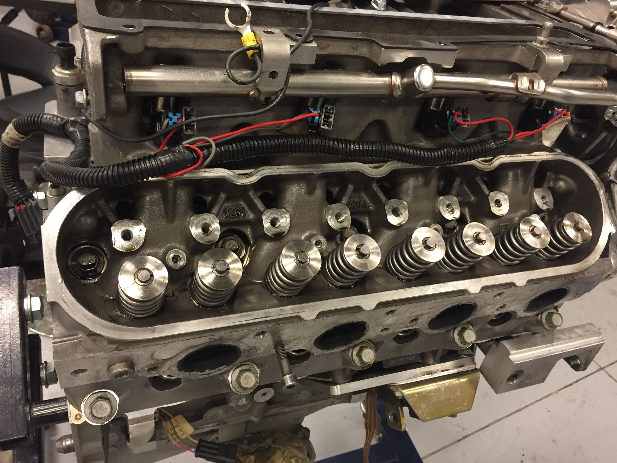

new cam + springs ..

Fuel cell pump filter ,almost complete, the intercooler pump missing
If anyone has any idea to do it better or if I'm doing something wrong .... please tell
