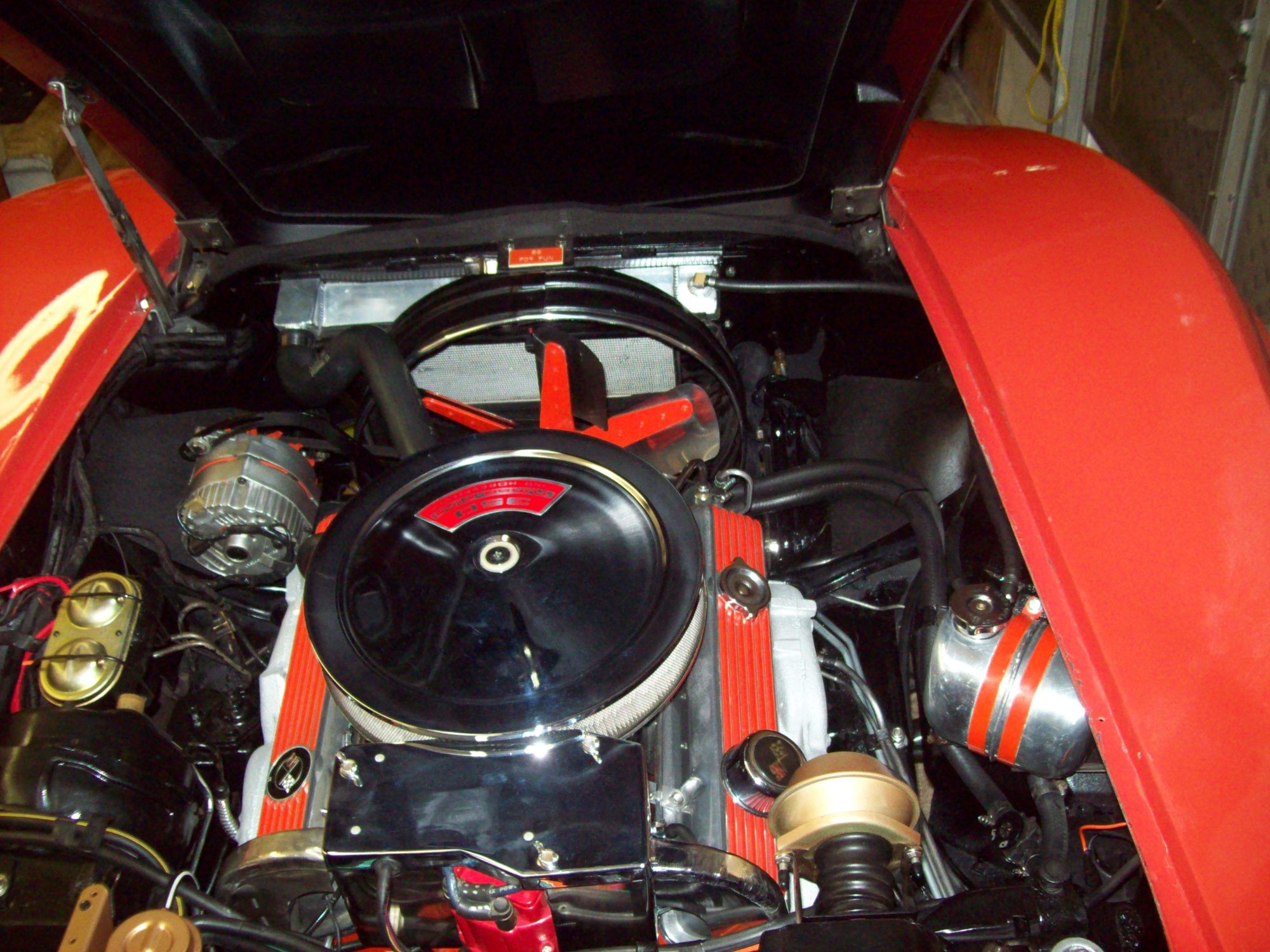

To use the chrome on the HEI dizzy, you will have to modify the main "wrapper". The top does not need to be altered.
Rather than cut up the chrome on mine, I made the "wrapper" in two pieces out of polished Stainless Steel.
